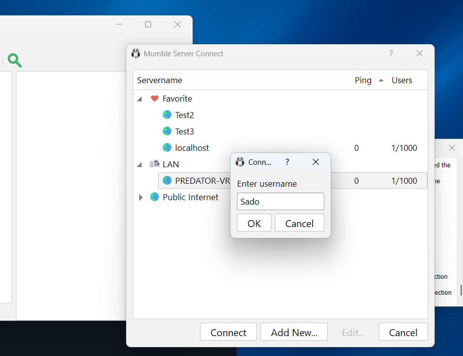

  2. As of SightLab 2.7 Mumble is installed with the SightLab installer (unless you uncheck it) and there are buttons on the server and client to automatically launch the server and client.
  1. If running prior to Sightlab 2.7: Download the Mumble server and client from the links below. On the computer running the SightLab server, run the mumble server and for each client start the Mumble Client, press the settings to configure your audio (headset mic and headphones if using VR) and connect to the session with the same hostname as the SightLab server.
