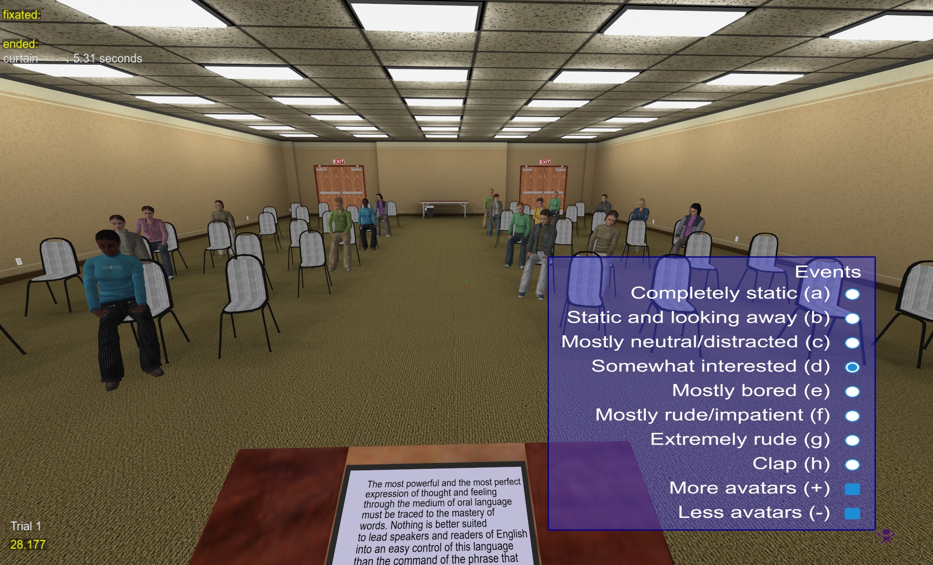

The following parameters can be manipulated by the experimenter via a
separate screen:
  1. Are the other people looking at you?
  2. Are the other people displaying frowns or smiles?
  3. Are the other people showing boredom?

Key Mapping:
  • Scroll the text the subject is reading - o or l (lower case o or L) keys (or subject can use LH controller X and Y buttons to do this themselves)
  • Raise or lower the curtain - "Z" or click on the button with the mouse
  • Increase or decrease the number of avatars - "+" or "-" (or click on button)
    Change Avatar attitudes- keys "a-h" (or click on buttons)
