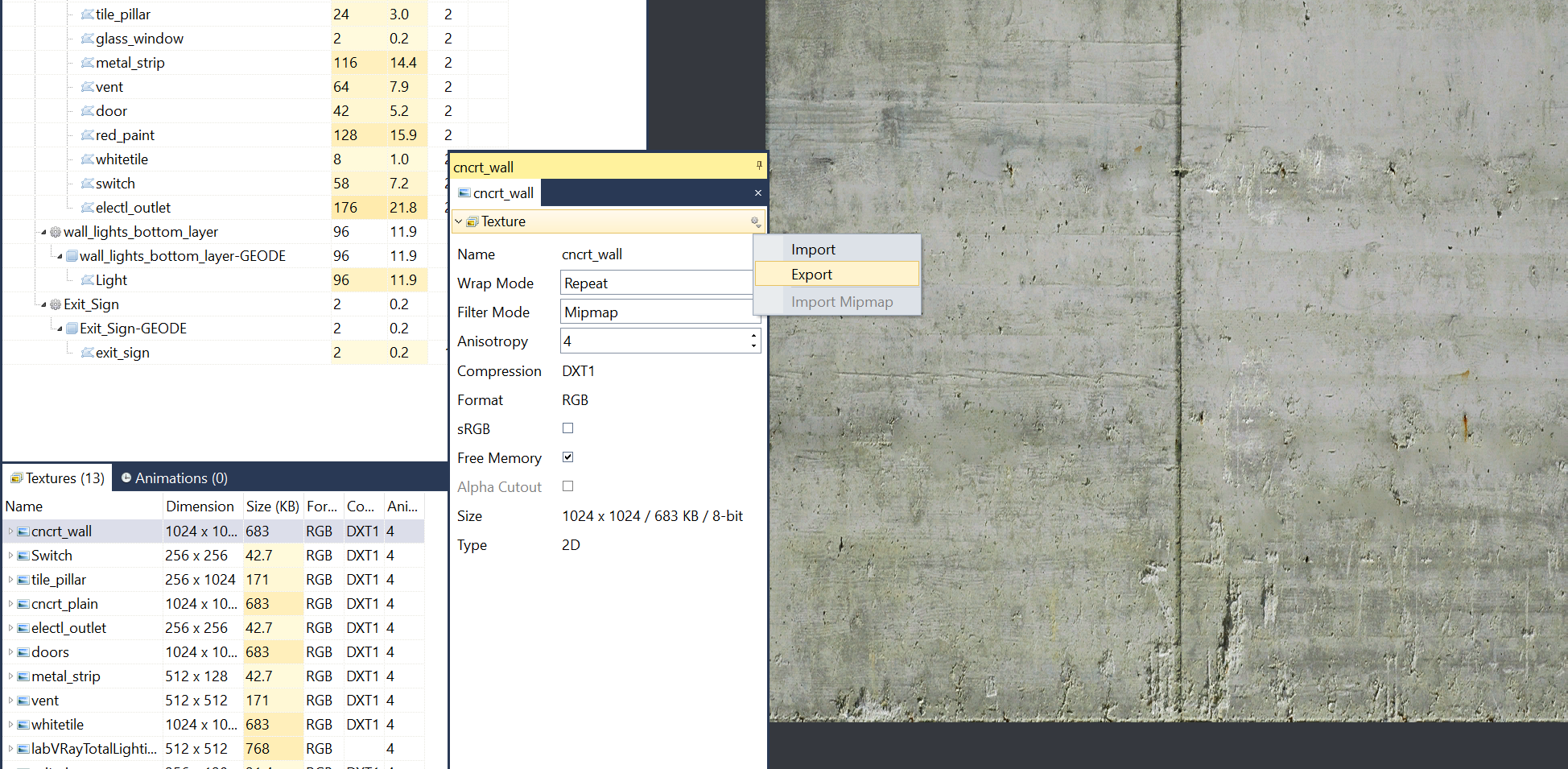

.osgb, .osg, .ive osgconv → .obj → Blender → .glb (note: Textures need to manually be saved first)

For osgb models need to first manually save the textures
right click on the texture - go to Properties - left click on the gear icon - save as .dds in the textures folder
Once they are in the textures folder run the converter script and the .glb model will be saved into output_folder\output_folder\webxr\models folder
Alternatively, you can just run the convert_models.py python script if you're only wanting to convert .osgb models

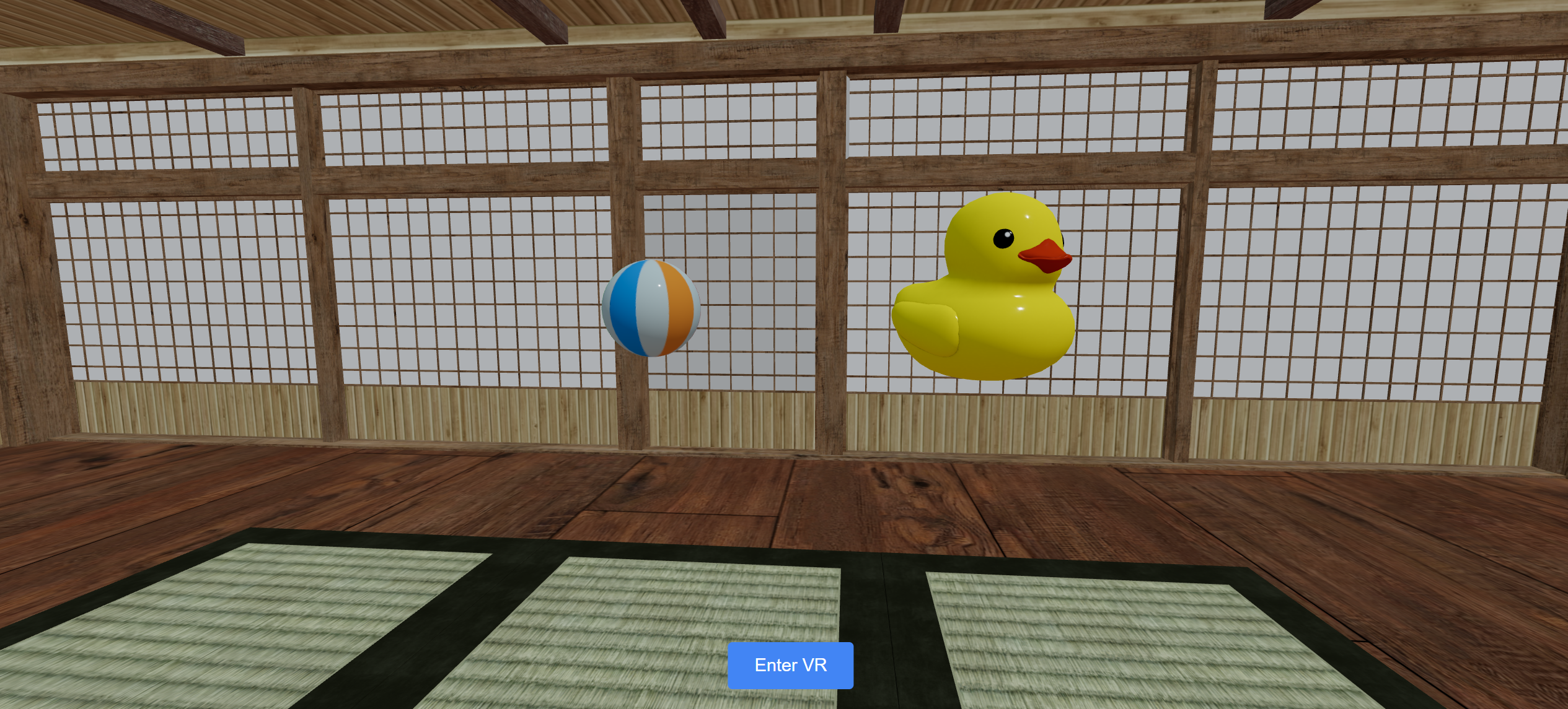

Supported Features
Model Loading
Vizard Code WebXR Translation
vizfx.addChild('model.glb') Three.js GLTFLoader
viz.addChild('model.glb') Three.js GLTFLoader
Model Transforms
model.setScale([x, y, z]) object.scale.set(x, y, z)
model.setPosition([x, y, z]) object.position.set(x, y, z)
model.setEuler([yaw, pitch, roll]) object.rotation.set() (radians)
pos= parameter Initial position
scale= parameter Initial scale
Visibility
model.visible(viz.TOGGLE) object.visible = !object.visible
model.visible(viz.ON) object.visible = true
model.visible(viz.OFF) object.visible = false

WebXR Controls
  • WASD - Move forward/back/left/right
  • Mouse - Look around (click to enable)
  • Enter VR button - For VR headsets
