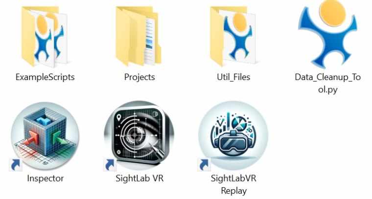

    • Double-click SightLab_VR.py in your project folder or the SightLab VR shortcut from the main Projects folder.

Note: You can also run the Inspector 3D model editor directly from the Inspector shortcut in the main SightLab projects folder, or from the "Tools" menu in the Vizard IDE.
