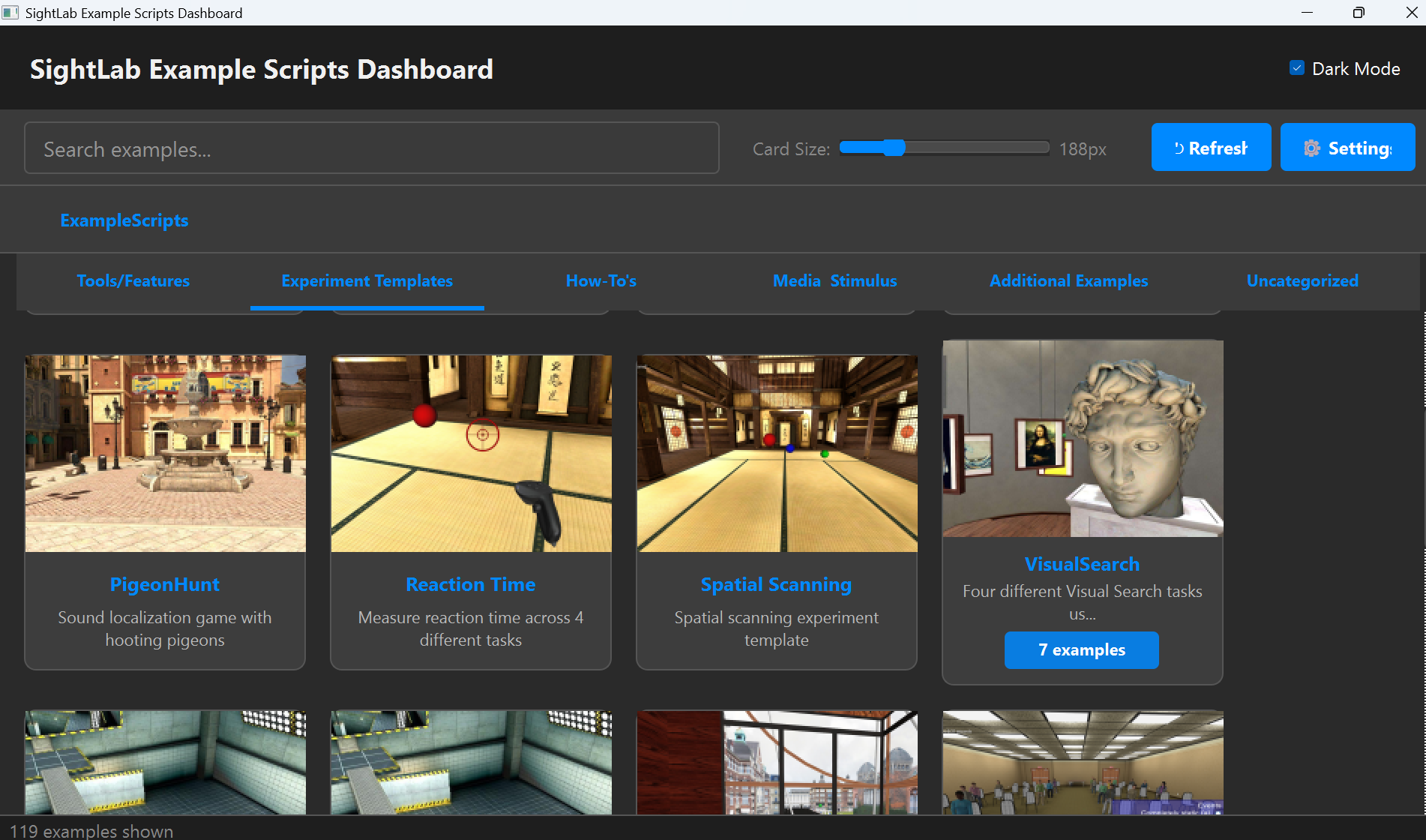

Main View
AI Agent

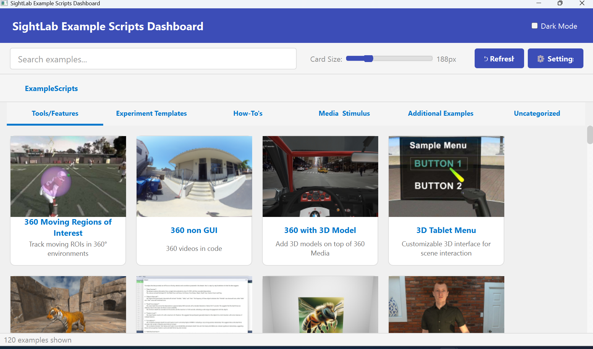

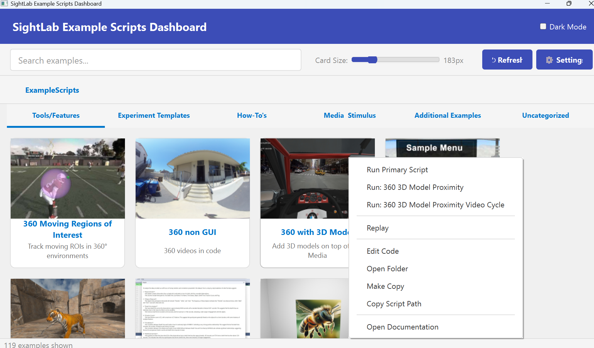

  • Toolbar — Search bar, card size slider (140–360px), Refresh button, Settings button
  • Category Tabs — Examples are organized into tabs:
  • Tools/Features
  • Experiment Templates
  • How-To's
  • Media & Stimulus
  • Additional Examples
  • Uncategorized
  • Card Grid — Responsive grid of cards showing thumbnail, title, and description
  • Status Bar — Shows count of visible examples vs. total
Card Interactions
  • Left-click a card to open its detail page
  • Left-click a group card to navigate into its children (with breadcrumb navigation)
  • Right-click a card for a context menu with quick actions (Run, Edit, Open Folder, etc.)

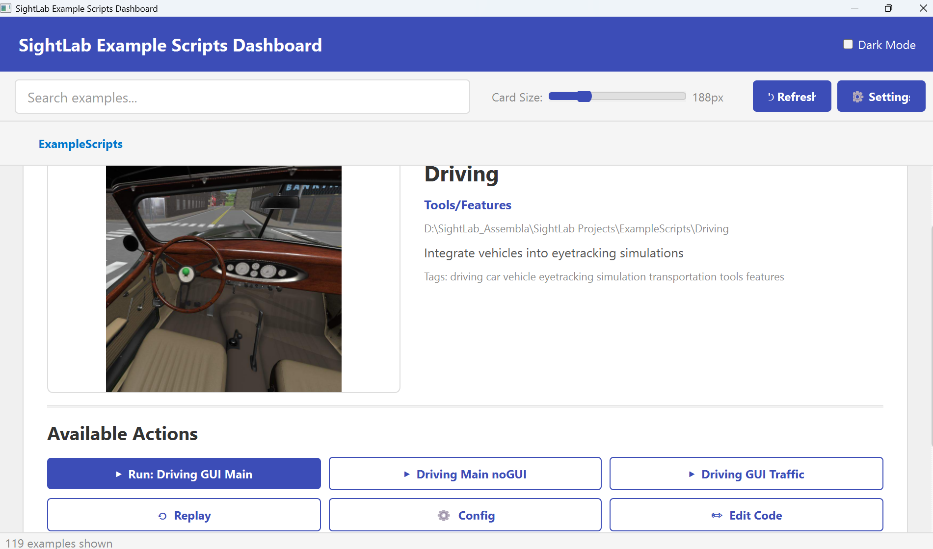

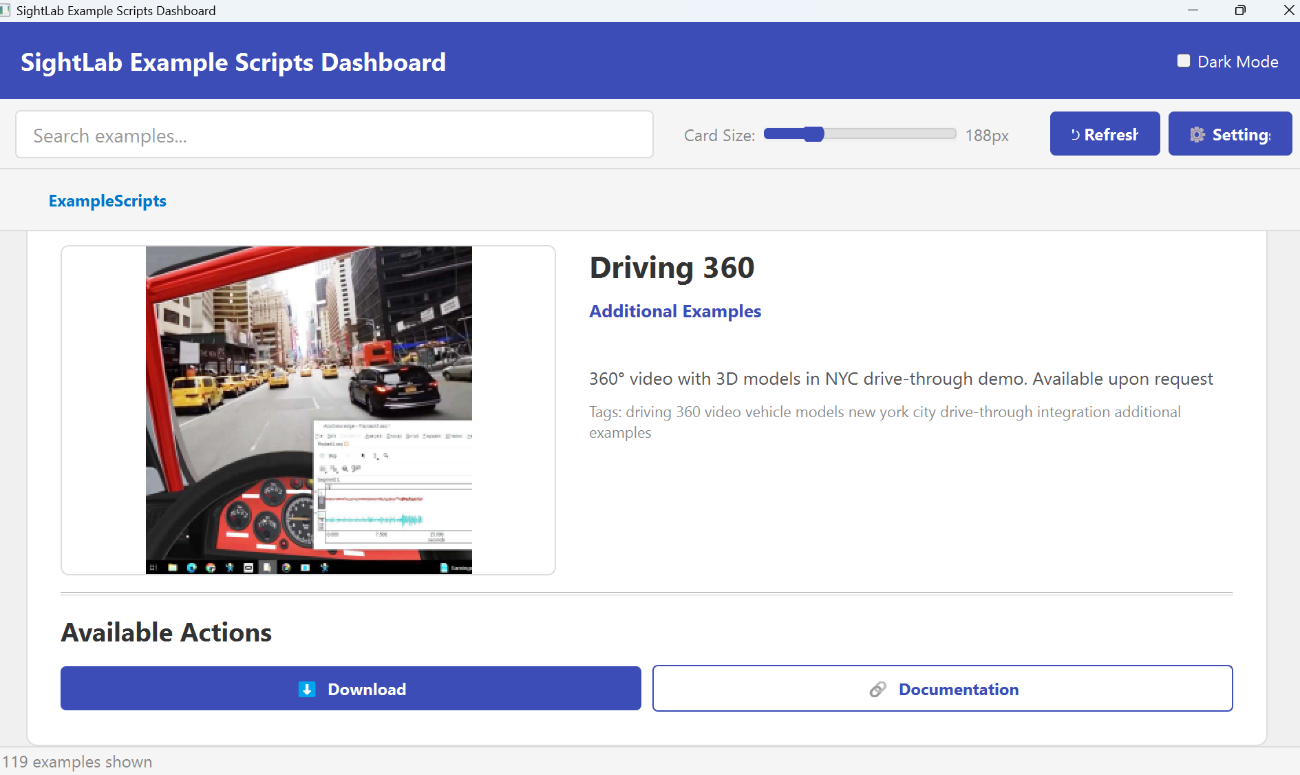

Detail Page
Shows full information about an example:
  • Large thumbnail (360×240)
  • Title, category, folder path, description, and tags
  • Available Actions grid with buttons for all applicable operations
  • "← Back to Library" buttons at the top and bottom

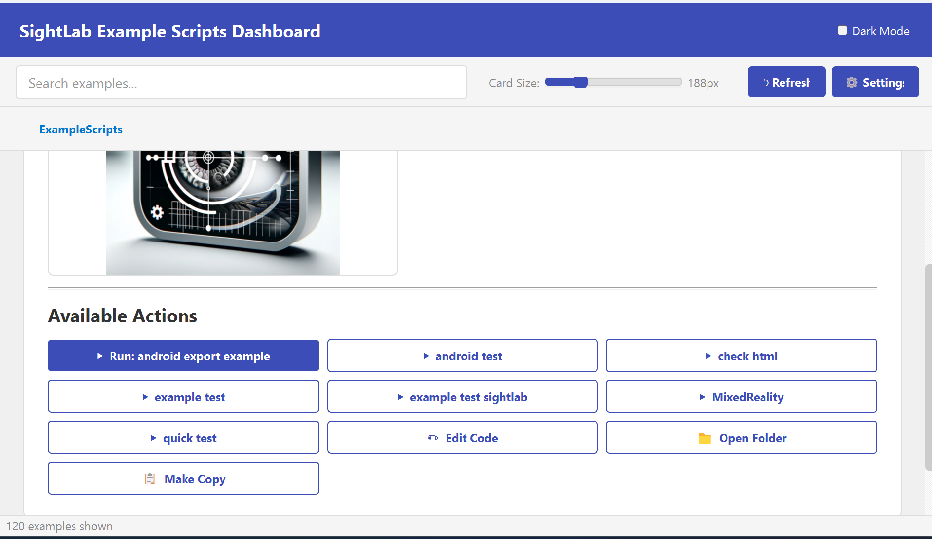

Available Actions
AI Agent
Button Description
▶ Run Launches the script in Vizard
▶ [Alternate] Runs an alternate script variant
⟲ Replay Runs the session replay script
⚙ Config Opens the configuration script in the editor
⬇ Download Downloads a remote example archive (for cloud-hosted examples)
✏ Edit Code Opens the primary script in the Vizard IDE
📁 Open Folder Opens the example folder in Windows Explorer
📋 Make Copy Copies the example folder to a chosen destination
🔗 Documentation Opens the online documentation page

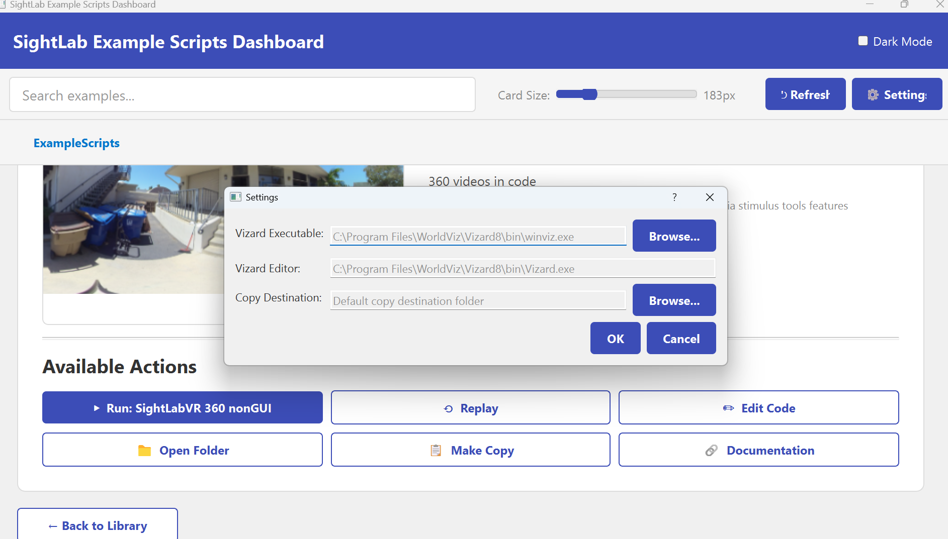

Settings
AI Agent
Click the ⚙ Settings button to configure:
  • Vizard Executable — Path to winviz.exe if not in the default location
  • Vizard Editor — Path to Vizard.exe IDE
  • Copy Destination — Default folder for the "Make Copy" action

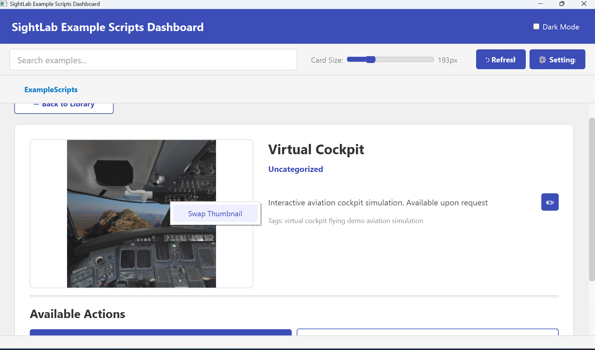

Adding Your Own Folders
Any folders added to the ExampleScripts folder will show up (by default under "Uncategorized"). In the details page you can right click on the thumbnail to swap it out and click the pencil icon to edit the description.
