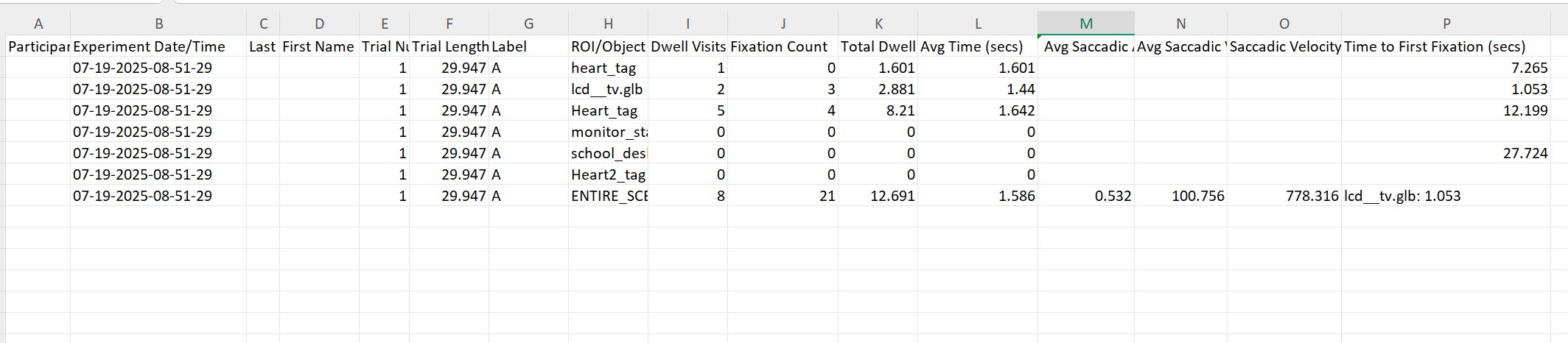

Experiment Summary - Shows a summary of the Dwell view count, fixation count, dwell time, average view time, per trial saccade calculations, time to first fixation, trial length, as well as any additional data that you want to summarize per trial. See documentation on how to add more data.
