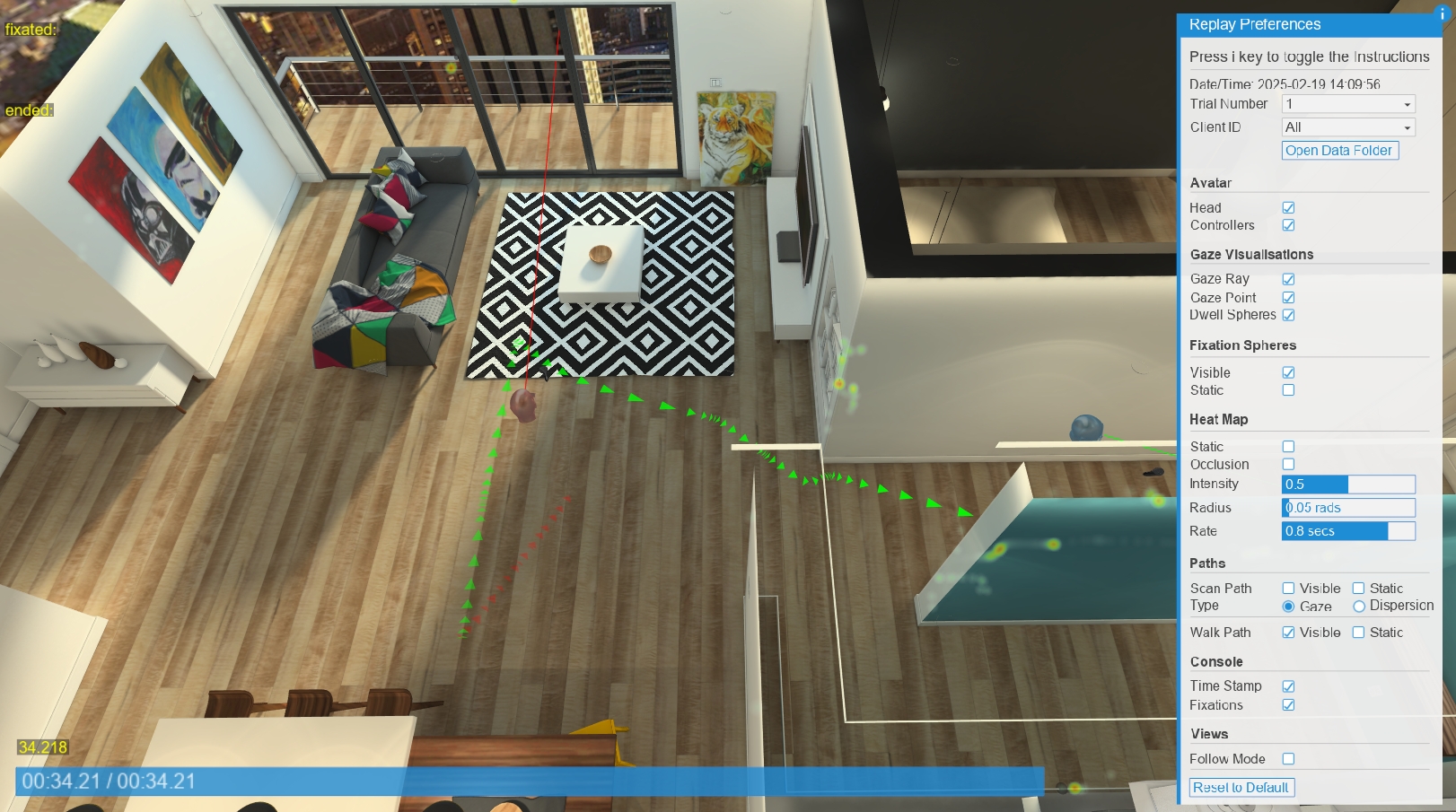

Avatar Visualization
- Toggle the display of the avatar (or avatars in multi-user mode). Head and hands are shown separately.
Gaze Visualizations
- Toggle:
- Gaze Ray: The line of sight from the user (individual or per eye).
- Gaze Point: The intersection of gaze and objects (individual or per eye).
- Dwell Spheres: A sphere related to objects of interest that will change size and color based on the time spent gazing at them, once the dwell time threshold is met.
Fixation Spheres
- Toggle visualization of fixation spheres. Fixations are calculated based on:
- Angular distance (<1 degree).
- Duration (>100 ms, default; configurable).
- Click Static to view all fixations at once.
- First: Shows the time and location of the first fixation
- All: Will show a numbered sequence of all the fixations

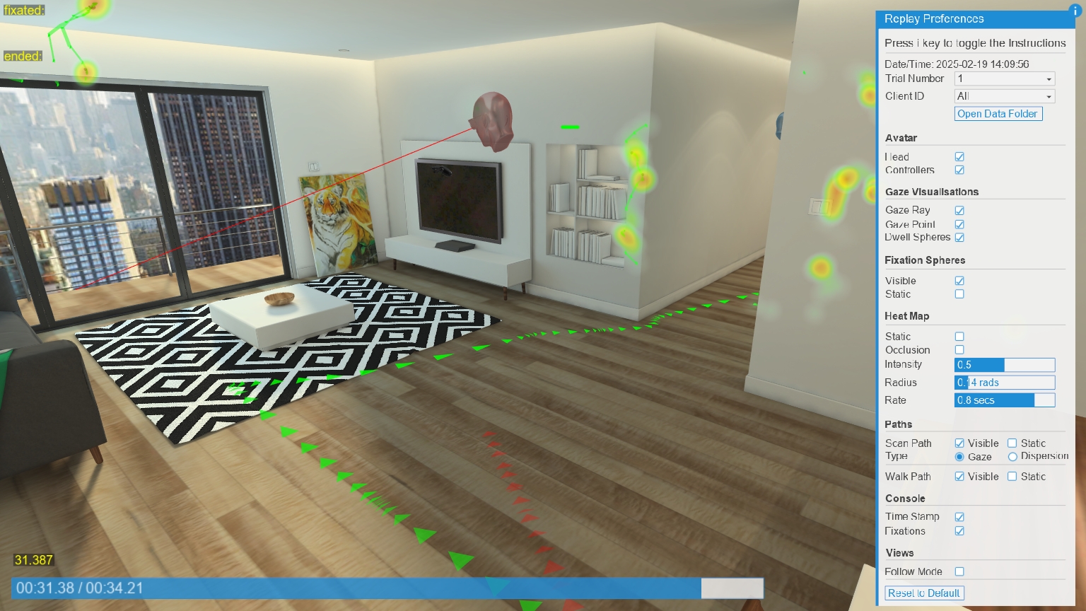

Heat Map Visualization
- Provides a dynamic representation of gaze data:
- Dynamic Mode: Displays gaze over time during playback.
- Static Mode: Aggregates all gaze data into a single heatmap.
- Occlusion Setting: Enables heatmaps that respect physical barriers (e.g., walls).
- Note: requires setting fastHeatmap = False and can affect frame rate.
- Gradient: A heatmap that fades over a specified time.
- Adjust parameters using sliders for intensity, decay rate, and transparency.
- Note: If running a trial longer than 2 or 3 minutes you can switch to the faster heatmap if loading times increase or frame rate drops (replay = Replay.SightLabReplay(fastHeatmap = True) )
Scan Path
  • Visualize gaze paths dynamically or statically.
  • Options:
  • Gaze Path: Tracks gaze movement.
  • Dispersion Path: Tracks areas of focus.
Walk Path
  • The walk path will show arrows in the direction that a user walked and will also show velocity based on the spacing between arrows. Walk Path can be shown as static or dynamic.

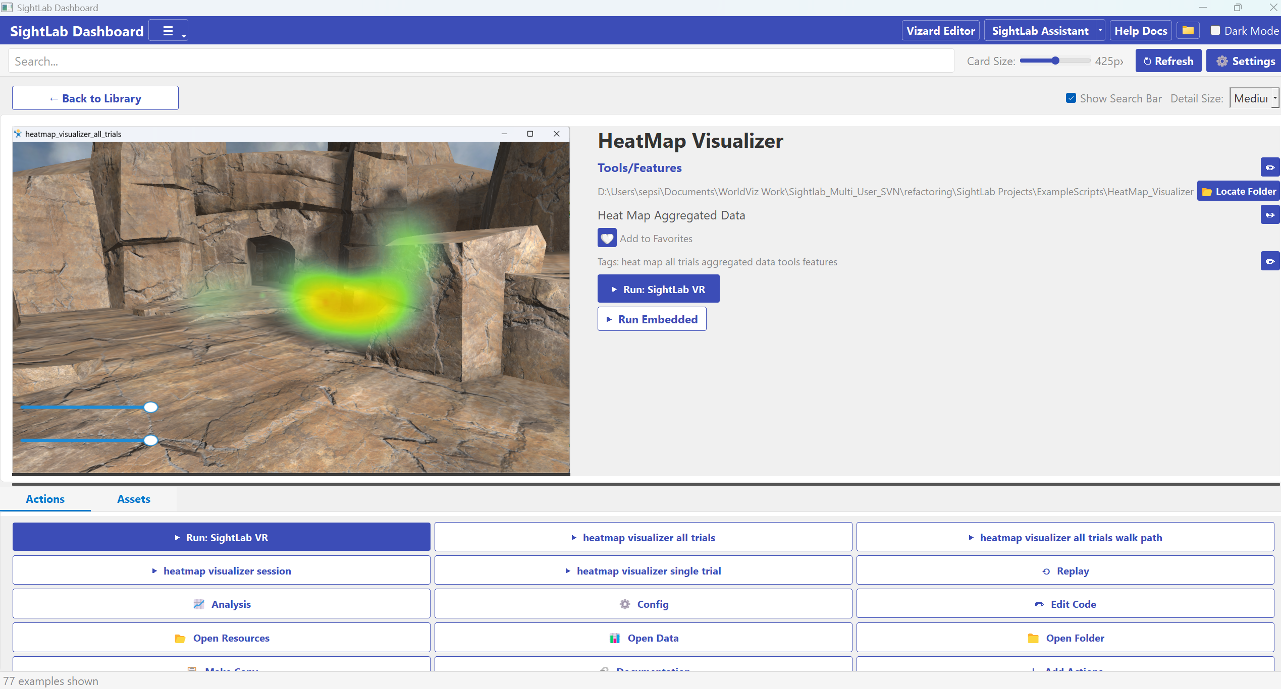

Heatmap Aggregation
See where people looked across many recordings of the same scene, whether from different participants or from one participant over several trials and sessions. The Group Heatmap Replay example merges every recording of a scene in a data folder into one session that plays back like a multi-user session, with each recording as its own client and one heatmap that adds up all the gaze. It works for 3D environments and 360 media.
Download Group Heatmap Replay
Group Heatmap Replay of a 360 video: four participants' gaze points and the combined heatmap
To use it
  1. Download the example and extract it anywhere, for example into your ExampleScripts folder.
  2. Run merge_sessions.py and select the data folder of the project you recorded with: the folder that holds the <date>_experiment_data folders (for example MyProject\data). Every scene recorded at least twice becomes one trial of the group session.
  3. Run group_heatmap_replay.py and pick the session ending in _GROUP.
Group sessions use the same controls as the regular Session Replay:
  • The Heat Map settings (Static, Intensity, Radius, Rate) apply to the combined heatmap. Static shows the whole trial at once.
  • Choose a client under Client ID to show only that recording's gaze and heatmap. Choose All to see them combined again.
  • Take a screenshot with / or save an equirectangular image with 3.
