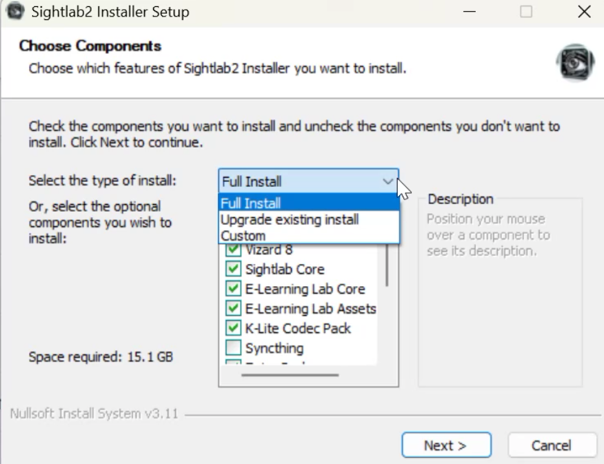

Choose Components: Keep all components checked and choose "Full Install" if installing for the first time. If only upgrading choose "Upgrade Existing Install" (note older installers may not have this dropdown and can just keep all checked if installing for the first time) This also includes the "E-Learning Lab" add-on, Ollama for offline AI Agents, Mumble for mutli-user audio, K-Lite Codec Pack, FFMPEG and (unchecked by default): Libre Office and Syncthing. |

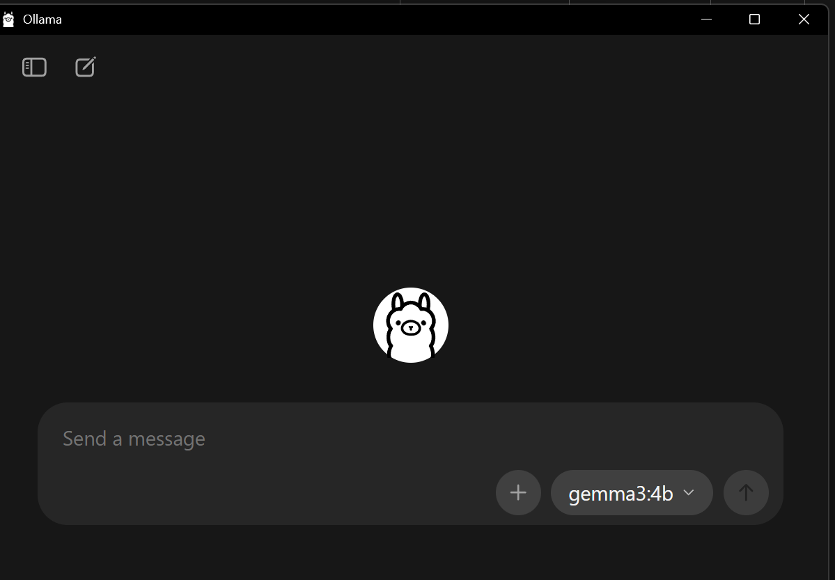

Close Ollama (if installed): The latest installer includes Ollama for the AI interactions. You can close the Ollama interface after installation as it stays open by default and is not needed. |

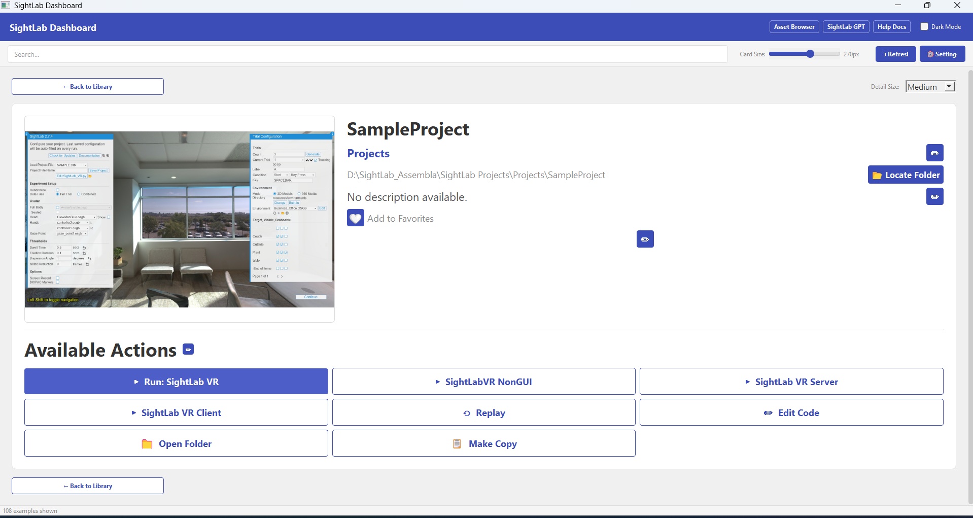

Open Sample Project (2.8.0 and later): Open SightLab Dashboard, left click Sample Project and choose "Run SightLab VR" to open the sample project (see quick start for a quick overview of using the GUI). |

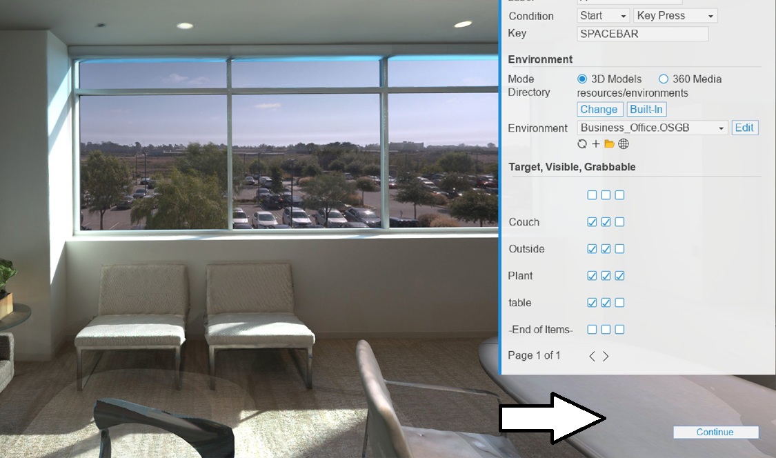

Press "Continue" to start session Choose Hardware Click "BIOPAC Markers" checkbox if running with BIOPAC Acqknowledge |

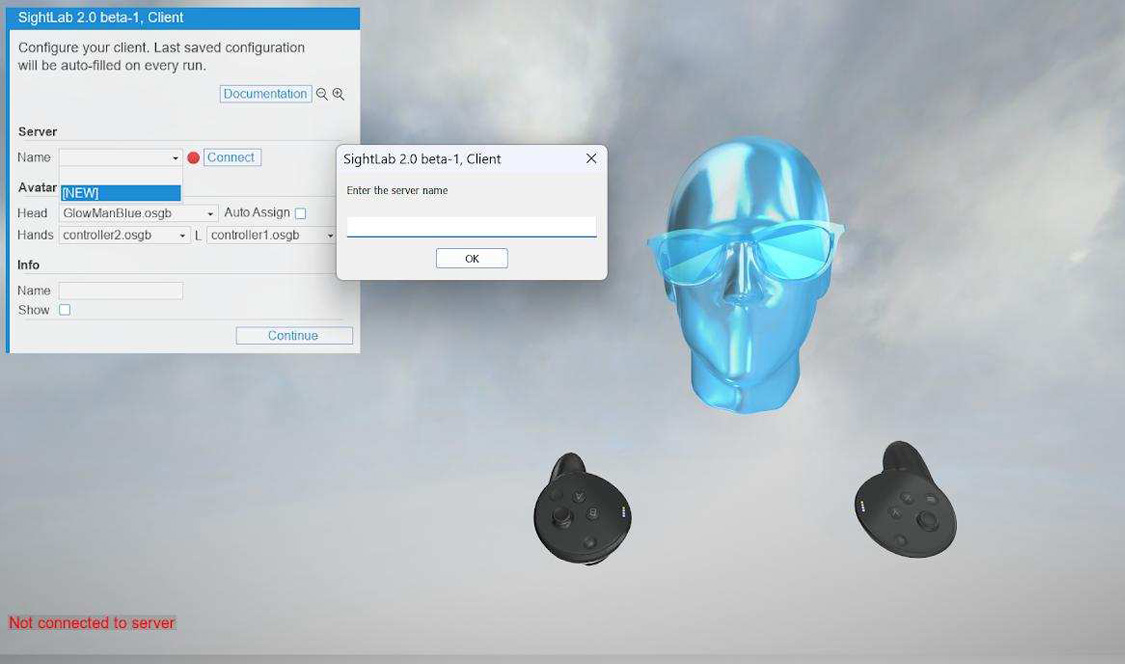

Multi-User: If using Multi-User, run SightLab_VR_Server and (optionally) SightLab_VR_Client on one machine, then SightLab_VR_Client on additional machines. |
Connect Client: Enter the server's computer name and click connect on the client (to get the server's computer name can type "About" in Windows search. Select options and hardware then click Continue. |
Start Server Session: Start the session with the server and press spacebar. Verify can see each other/interact/etc. See this page for more information. |
