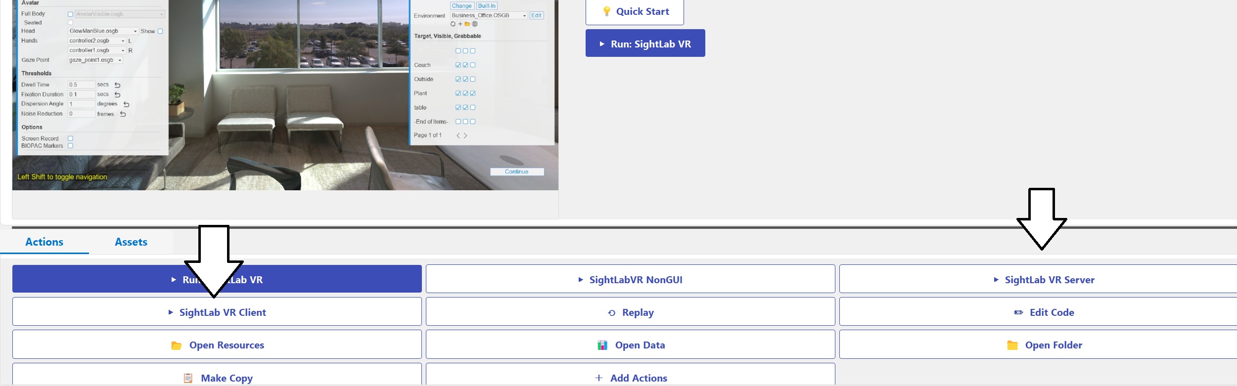

Note: If using the new SightLab Dashboard, each script will have its own server and client scripts you can launch from the "Actions" menu.
SightLab_VR_Server.py is for running a session as the server using the GUI interface.
SightLab_VR_Client.py is for running each client that will connect to the server.

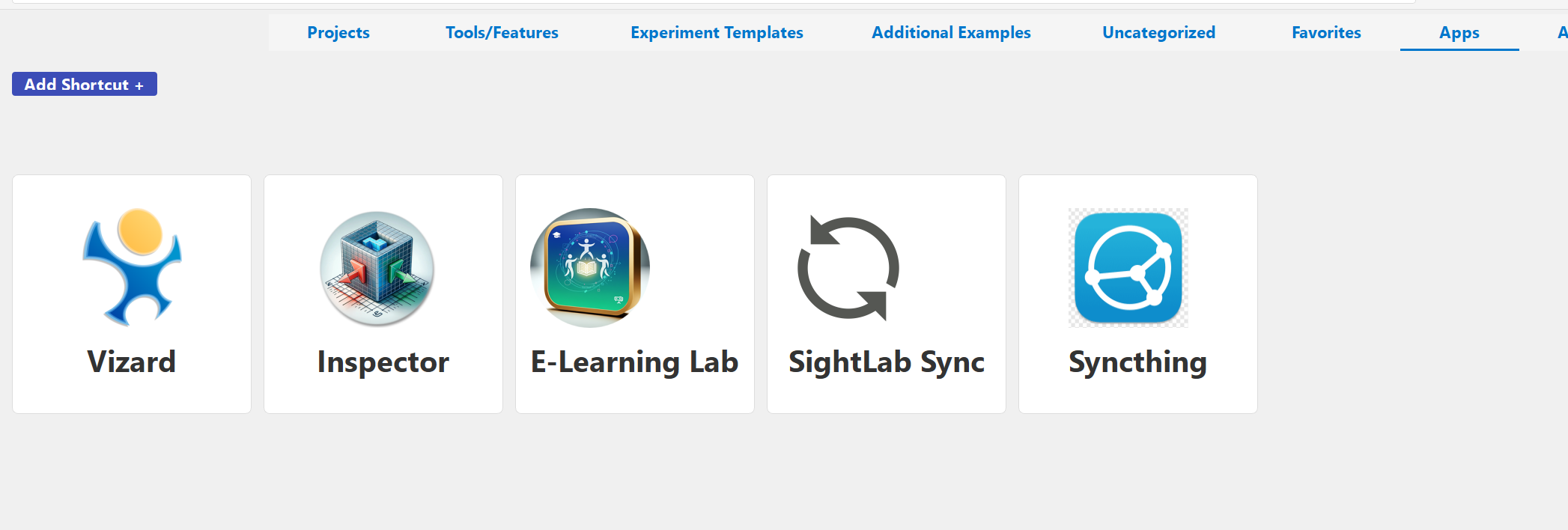

Every computer needs a copy of the project. In SightLab 2.9.3 and higher, SightLab Sync copies projects in the Shared folder to every computer automatically; see Sharing Multi User Resources. Open it from the SightLab Sync tile in the Dashboard's Apps tab (or Advanced → Tools → SightLab Sync in E-Learning Lab), and click Make this machine the primary on the server computer.
SightLab Sync in the Dashboard's Apps tab

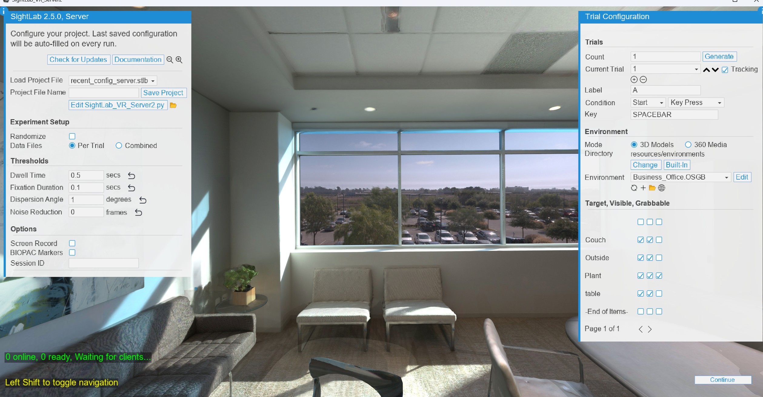

Run SightLab_VR_Server to start the main server. All clients will connect to the main server.
Set up all your experiment options as usual according to this page. Enter a Session ID that will be used for the data files as well if you wish.

On the server side it will show how many clients have connected and how many are ready. Click "Continue" when the necessary clients are ready.
