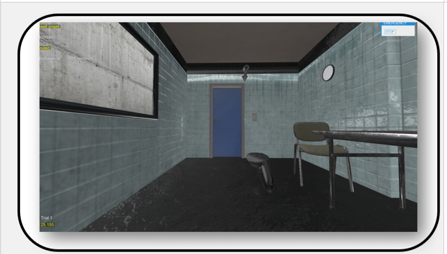

Participants are seated in a sparsely furnished virtual room and observe two colored doors, blue and red, presented one at a time across three experimental phases. The blue door serves as the conditioned stimulus (CS+), and on the majority of acquisition trials it is paired with an aversive unconditioned stimulus (US): a virtual monster that leaps through the open door accompanied by a 100 dB female scream. The red door is never paired with the US. Through repeated exposure, participants learn to associate the blue door with threat, and that learned fear is then measured and subsequently extinguished in later phases.

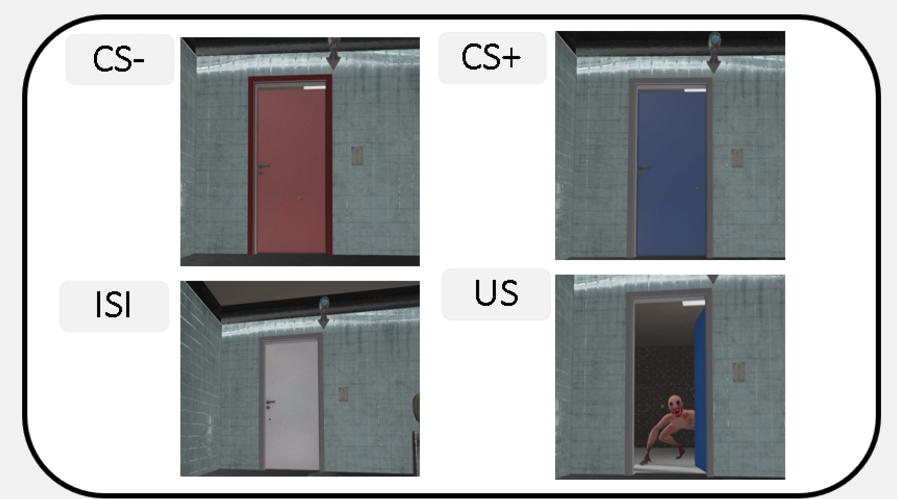

Every trial, regardless of phase, follows the same fixed 15-second structure:
- 0-9 s - Closed-door presentation: The CS door, blue or red, appears closed. This is the critical window for SCR measurement.
- 9-12 s - Open-door window: The door rotates open with a realistic swing animation, 90 degrees over approximately 1.2 s. On reinforced CS+ trials, the monster appears immediately at t = 9 s, looms for 2 s, then leaps toward the participant over the final 1 s, accompanied by a 100 dB scream.
- 12-15 s - Inter-trial interval (ITI): All CS doors are hidden. The neutral door, if present in the scene, is shown briefly as a placeholder, then also hidden before the next trial begins.
Stimuli
- CS+ (blue door): A blue-colored door in the virtual room. During acquisition, paired with the US on 80% of trials.
- CS- (red door): A red-colored door. Never paired with the US.

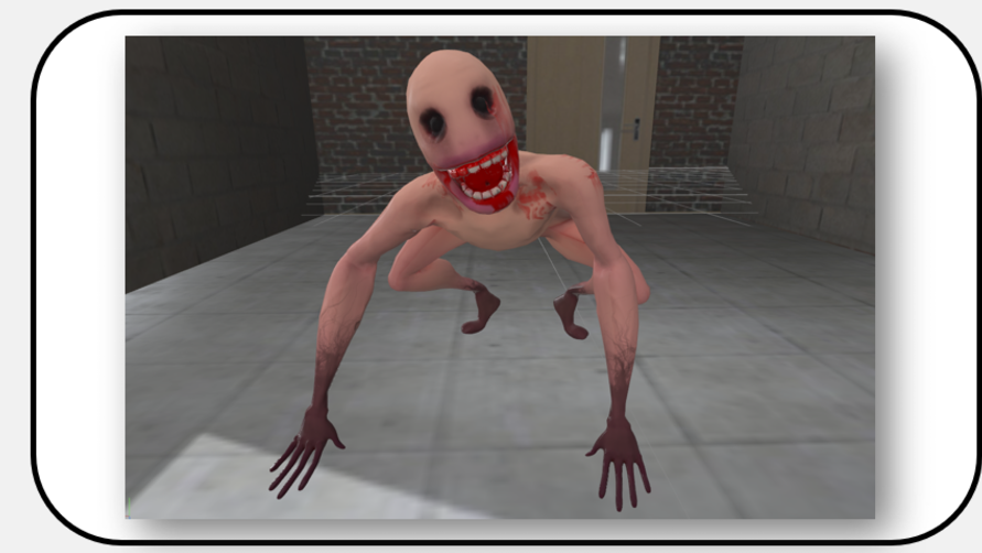

- US - Monster: A virtual monster,
smily_horror_monster.osgb, loaded as a Vizard avatar, positioned in the doorway, playing an idle/loom animation for 2 s before leaping 4.5 m toward the participant's viewpoint over 1 s. - US - Scream: A mono WAV file,
scream.wav, played as 3D audio attached to the monster object so that it spatializes correctly as the monster leaps. Engine volume is set to 1.0; the absolute 100 dB SPL level must be verified with a sound-level meter on the headphones before each session.

Runtime Controls (Researcher GUI)
The researcher operates the experiment from a desktop overlay panel, not visible in the HMD. It provides:
- Habituation / Acquisition / Extinction buttons: Launch the corresponding phase. A re-entry guard prevents accidental double-press while a phase is running.
- Emergency STOP button: Immediately flushes the log and quits the Vizard simulation. Use in case of participant distress.
