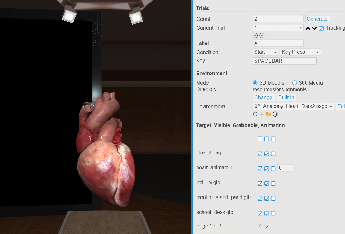

In the trial setup panel
Once the environment is loaded, animated nodes appear in the Target, Visible, Grabbable, Animation list with a 🎬 prefix. The Animation column shows a state textbox.
The state number is a 0-based animation clip index — 0 selects the first clip, 1 the second, and so on. There is no "stopped" state; entering any valid index will play that clip. To prevent playback you would need to control speed in code instead (see below).
Set the state per trial. SightLab applies setAnimationState(), setAnimationLoopMode(), and setAnimationSpeed(1.0) (full speed) automatically when the trial loads.
