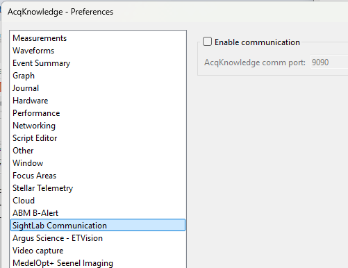

  3. Next to go Display > Preferences > Sightlab Communication and "Enable Communication" (see below)
  4. Restart the AcqKnowledge software to activate the Network Data Transfer.
This configuration only needs to be done once.

First in Acqknowledge to to Display - Preferences and make sure "SightLab Communication" and NDT are checked on. Click "Enable Communication" to toggle on this feature.
