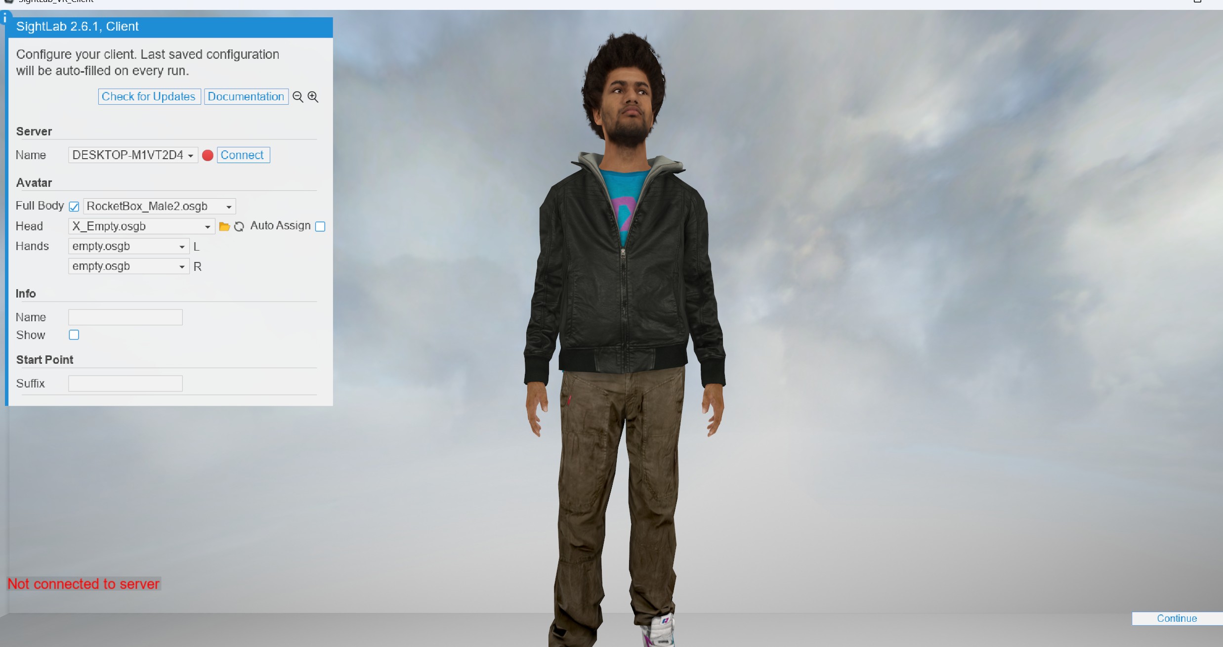

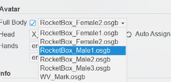

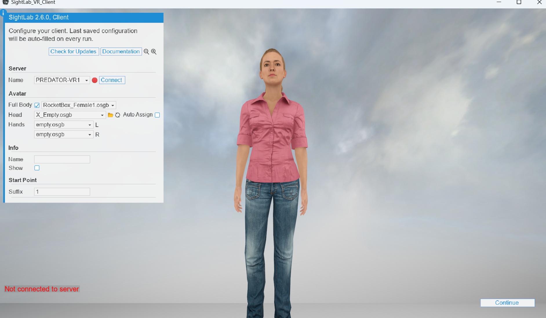

1.1. From the GUI (Single or Multi-User)
In both the SightLab GUI and Multi-User Client, simply:
- Open the project
- Go to Avatar Settings
- Enable ✔ Full Body
This unlocks the list of compatible avatars stored in:
C:\Program Files\WorldViz\Sightlab2\sightlab_resources\avatar\TrackedAvatars
Avatar Preview
- Multi-User Client shows the preview automatically.
- Single-user GUI → click Show to display the avatar in the scene.

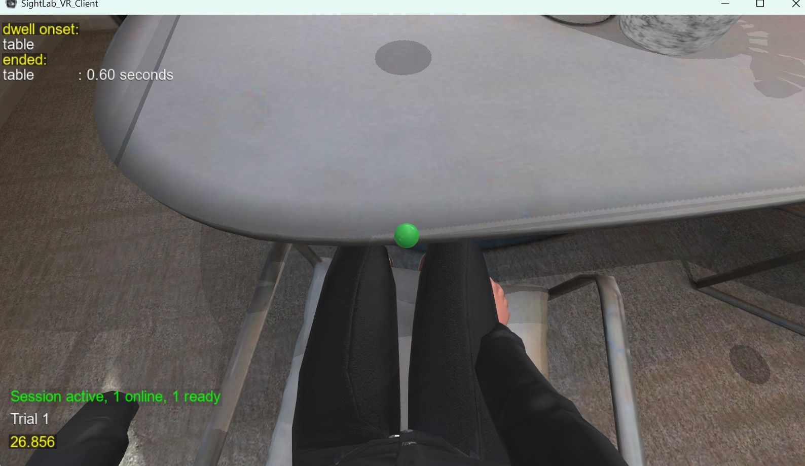

4.1 Data Logged by Default
SightLab automatically saves the following metrics regardless of hardware:
Head & Hands
- Head pose (position + rotation)
- Hand pose (position + rotation)
- Controller button states
Gaze & Fixations
- Combined and per-eye gaze intersection points
- Fixations, saccades, and dwell metrics
- Gaze timestamps and event markers

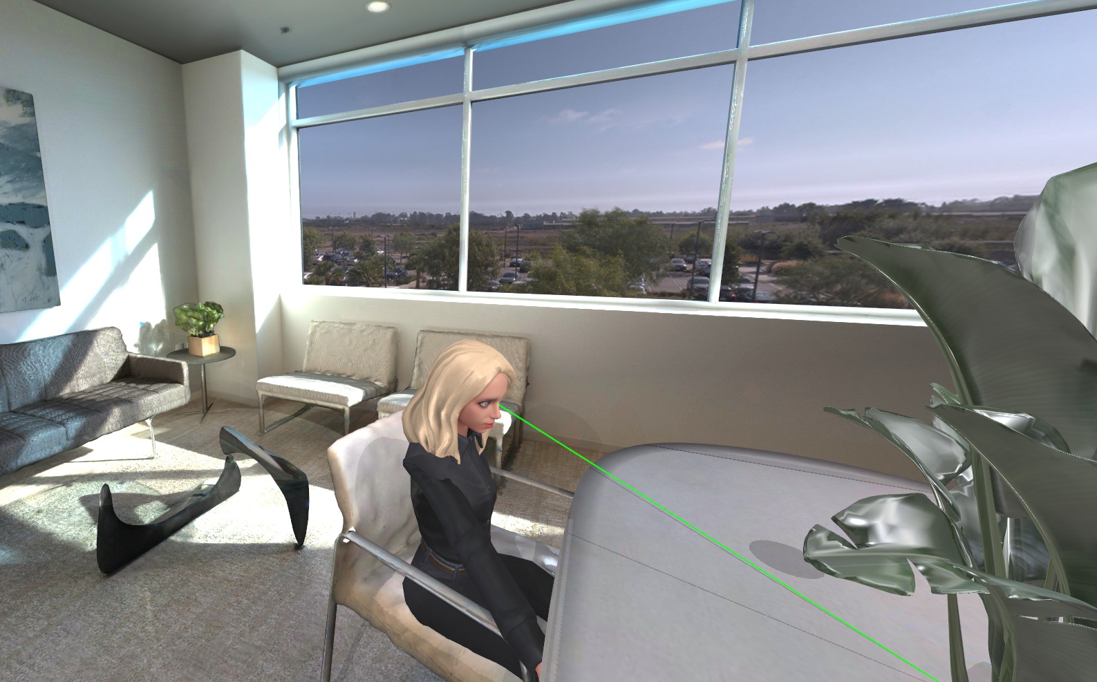

6. Showing Avatars in the Replay
The full body avatars do not show in the replay and will show a stand-in head and hands. If you don't see the stand-in head and hands (pre SightLab 2.6.4) you can add this code:
import vizfx
from sightlab_utils import replay as Replay
from sightlab_utils.replay_settings import *
replay = Replay.SightLabReplay()
#where '1' is the first client, '2', second, etc.
avatarHead = replay.sceneObjects[AVATAR_HEAD_OBJECT]['1']
glowbot = vizfx.addChild(r'C:\Program Files\WorldViz\Vizard8\bin\lib\site-packages\sightlab_utils\resources\avatar\head\GlowManBlue.osgb')
def replaceAvatarHead():
viz.link(avatarHead,glowbot)
vizact.onupdate(0,replaceAvatarHead)

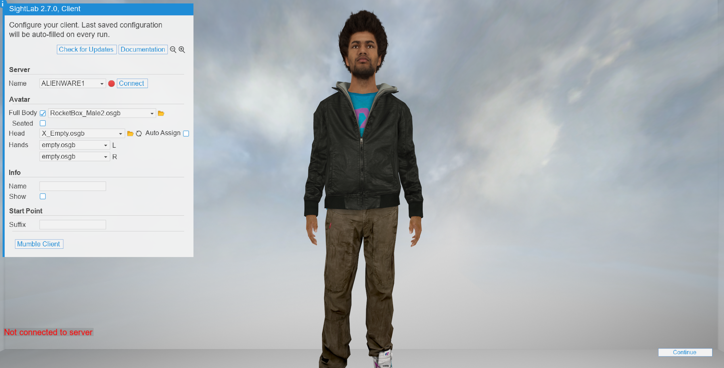

7. Seated Mode
As of SightLab 2.7 you can now enable "Seated Mode" on any Full body avatar to lock the avatar in a seated position while still maintaining the ability to move the head and hands using inverse kinematics. To enable this just check "Seated" on the GUI, or in code can use sightlab.setSeatedMode(True)
