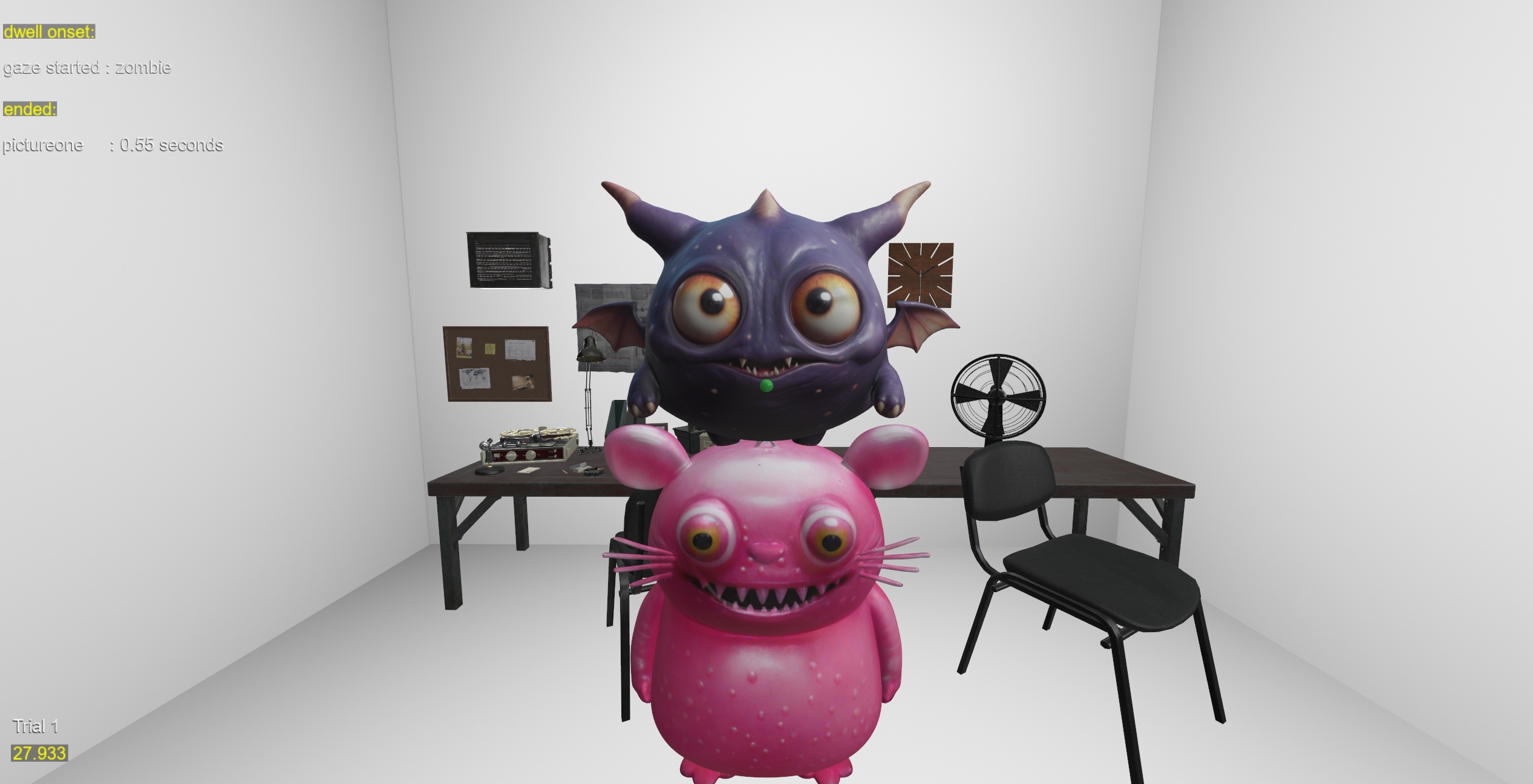

  1. inserts a BIOPAC stimulus marker
  2. distorts the room briefly by scaling the environment
  3. flashes a red strobe light
  4. places a monster directly in front of the user
  5. plays a scare sound
  6. fades the monster back out after a short delay
The first scare places the monster about 1.5 meters in front of the user, while the second one is placed closer, at about 0.7 meters in front of the user. Both use the current head position and yaw to spawn the figure directly in front of the participant. fileciteturn1file2 fileciteturn1file8 fileciteturn1file17
Because the scare is anchored relative to the participant viewpoint, it remains effective regardless of where the participant is looking or standing.

This example is especially useful with Session Replay. SightLab writes replay data along with its other trial outputs, and replay can be used to inspect the participant’s scan path, dwell behavior, gaze point, interactions, and related visual analytics. SightLab documentation notes that replay supports analytics such as heatmaps, scan paths, dwell time, and user interactions.
For this jump scare study, replay is useful for questions like:
  • Was the participant looking at the changing object before responding?
  • Did the participant visually inspect the fan, clock, or pictures?
  • Did gaze lock onto the scare object immediately?
  • How did scan behavior change after the first jump scare?
The included example list also points to Session Replay as a standard SightLab workflow, and the replay system stores .rply files for playback.
