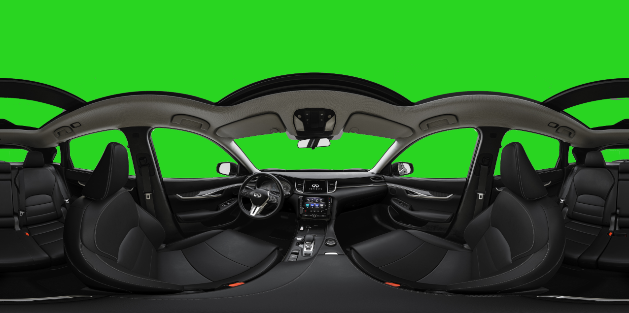

keyColor (0.20, 0.23, 0.28) Backdrop color (R,G,B in 0–1). Sample a clean wall pixel and divide by 255. Saturated colors (bright green, magenta, blue) work best — see Tuning the key.
threshold 0.02 Chroma distance below which pixels are fully removed. Higher = more aggressive key (eats subject). Practical range ~0.01–0.7.
softness 0.02 Width of the soft alpha edge beyond threshold. Higher = smoother silhouette but more bleed.
spill 0.2 Removes backdrop hue from edge pixels (skin tinting). 0 disables.

Tuning the key
The key operates on chroma only (BT.601 Cb/Cr), ignoring brightness. This is great for saturated backdrops and intentionally luma-independent (lighting falloff on the backdrop won't break the key), but it has implications:
  • Saturated keys work best. Bright green (0.0, 1.0, 0.0), magenta (1.0, 0.0, 1.0), or strong chroma-key blue give the cleanest results.
  • Gray / white / black keys do not work well. Gray is achromatic, so its chroma distance to many real-world pixels (skin, walls, shadows) is also small, meaning a wide swath of the video gets keyed out along with the backdrop. Use a saturated backdrop in your source footage when possible.
  • Desaturated colored keys (muted blue, beige, tan) are in between — workable but require careful threshold tuning.
Adjustment recipes:
Symptom Fix
Too much subject removed Lower threshold (try 0.015, 0.01)
Not enough backdrop removed (too much video, little passthrough) Raise threshold in steps (0.05 → 0.2 → 0.4); add softness (0.05–0.15) for smoother edges
Backdrop bleeds through at edges Raise threshold slightly, then raise softness
Subject has a blue/gray tint on shoulders/skin Raise spill (0.3–0.7)
Silhouette is jaggy Raise softness (0.03–0.06)
Hardly any video showing (~99% passthrough) threshold + softness is too wide for your key color, or the key color is too desaturated. Lower threshold first; if you need that wide a band to remove the backdrop, the backdrop color is too close to the rest of the scene — change the key color or pre-process the footage.
Effective key radius ≈ threshold + softness. Pushing the sum past ~0.7 will key out essentially everything in the frame.
For best results, sample the actual backdrop color from a video frame (paint app eyedropper, divide RGB by 255) instead of guessing.
For images or video with complex backgrounds it is recommended to use a tool such as Photoshop or Premiere to remove the background first.
