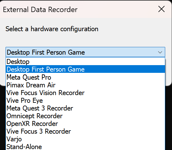

Click the green arrow in the utilities bar at the top to start the External Data Recorder. This is equivalent to clicking the Run: Exernal Data Recorder button in the Sightlab dashboard:
This will bring up a prompt asking you to pick your appropriate hardware config. For this tutorial, we are recording Krunker.io, so we'll choose the Desktop First Person Game option:

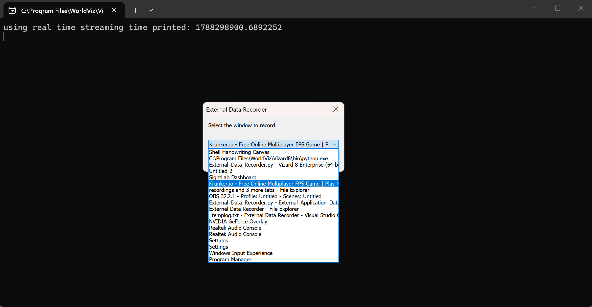

You will see more messages if DEBUG = True in Data_Recorder_Config.py. Right now the only message shown is that we are using real time streaming, which will open a mirror window showing the live gaze point.

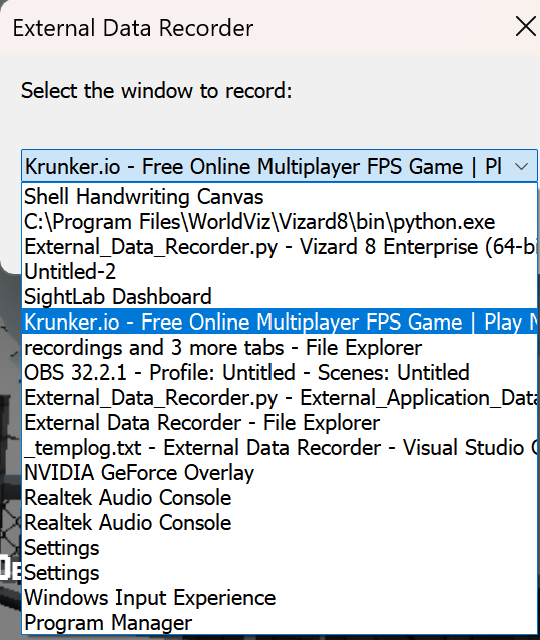

Next, you'll be prompted to choose which window to record:
Choose your desired window. We will choose the Krunker window.

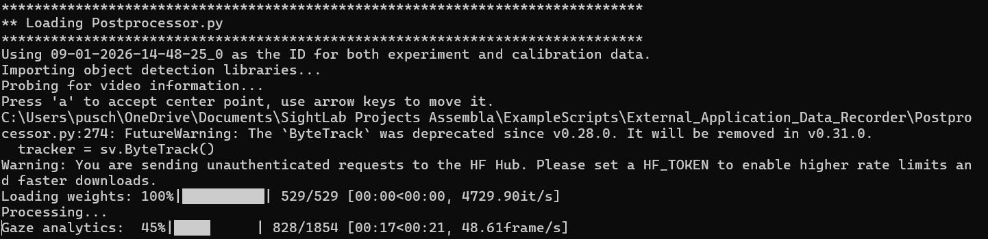

The console window provides postprocessing progress updates, and it will prompt you to crop the window region and adjust the centerpoint (if you chose Desktop First Person Game) if you wish to. See the postprocessing guide for more instructions. Updates on object detection and other postprocessing is shown in the console window:

Closing RAM/VRAM heavy processes can drastically speed up postprocessing times (60+ FPS postprocessing speed). Monitoring expensive processes with Task Manager can help you identify RAM/VRAM heavy processes to close.

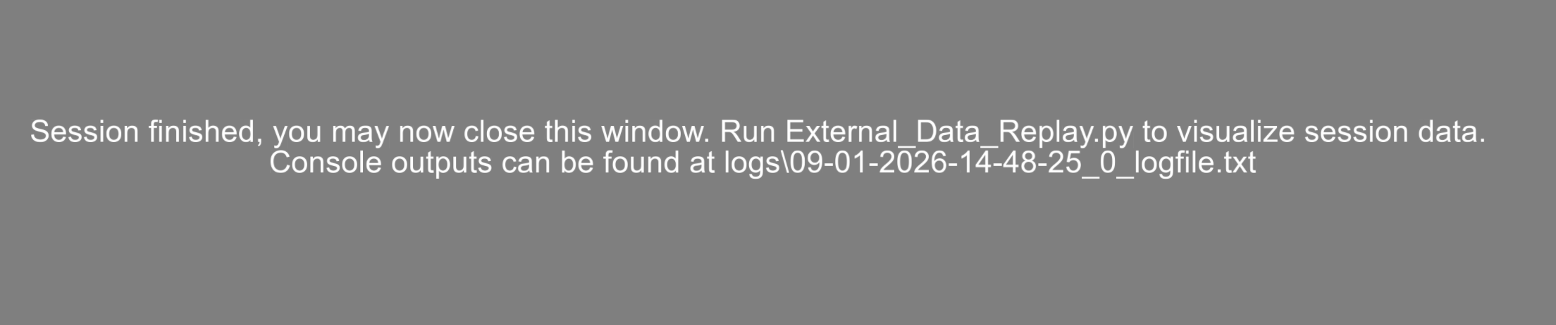

Once postprocessing is finished, the External_Data_Recorder window will let you know:
It is now safe to close the External_Data_Recorder window. This will save the console window outputs to a log file, listed in the message.

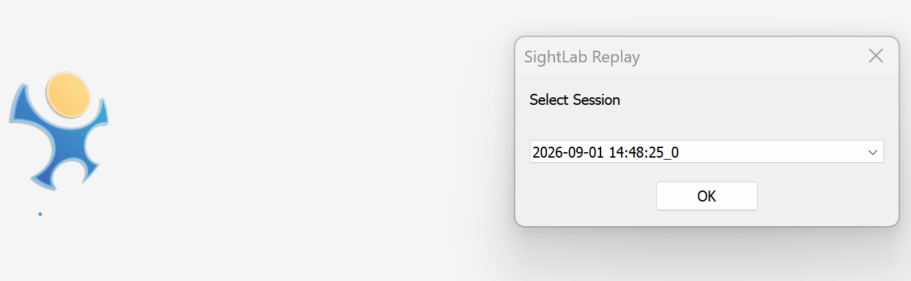

To operate the replay, you can open it from the Vizard IDE, directly, or the External Data Recorder tab in the SightLab Dashboard:
This will open a window named External_Data_Replay and prompt you to select a session. Sessions are named by the datetime they were recorded, and the participant id:

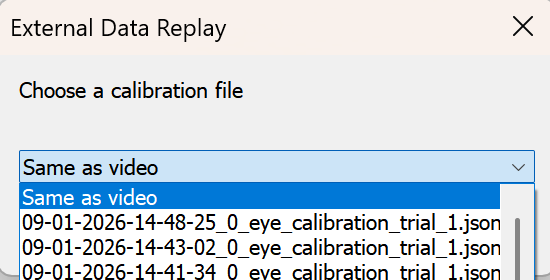

Next, it will ask you to select a calibration file to use with the selected session:
For Desktop and Desktop First Person runs, always choose Same as video, since you didn't run an actual calibration. A fake one is used to map the mouse onto the screen as gaze.

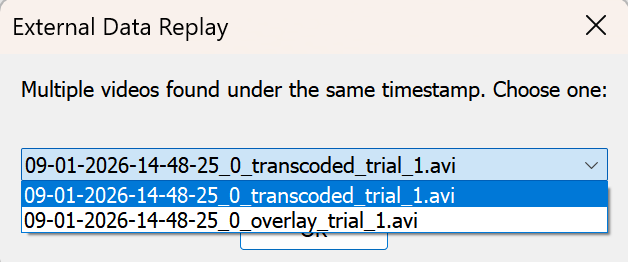

Next, select a video to use in the replay. You can choose from either the overlay video, which has the RT-DETR object detections overlaid on the video, or the transcoded video, which has no postprocessing overlays.
