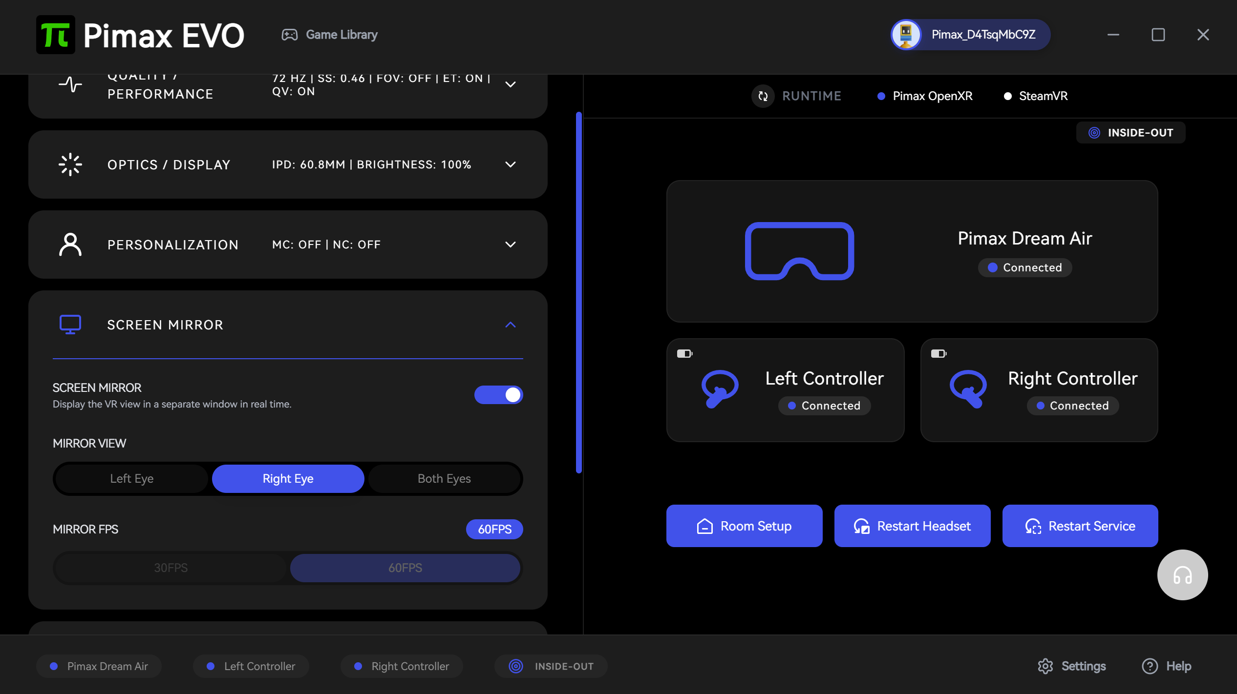

To enable the screen mirror, open the Screen Mirror tab on the left, enable Screen Mirror, and select Right Eye.
Note: This requires using Pimax EVO, not Pimax Play. Request Evo download link here https://store.pimax.com/pages/pimax-evo
To verify everything is ready, open the Pimax Mirror window and verify its view matches what you see in the HMD.

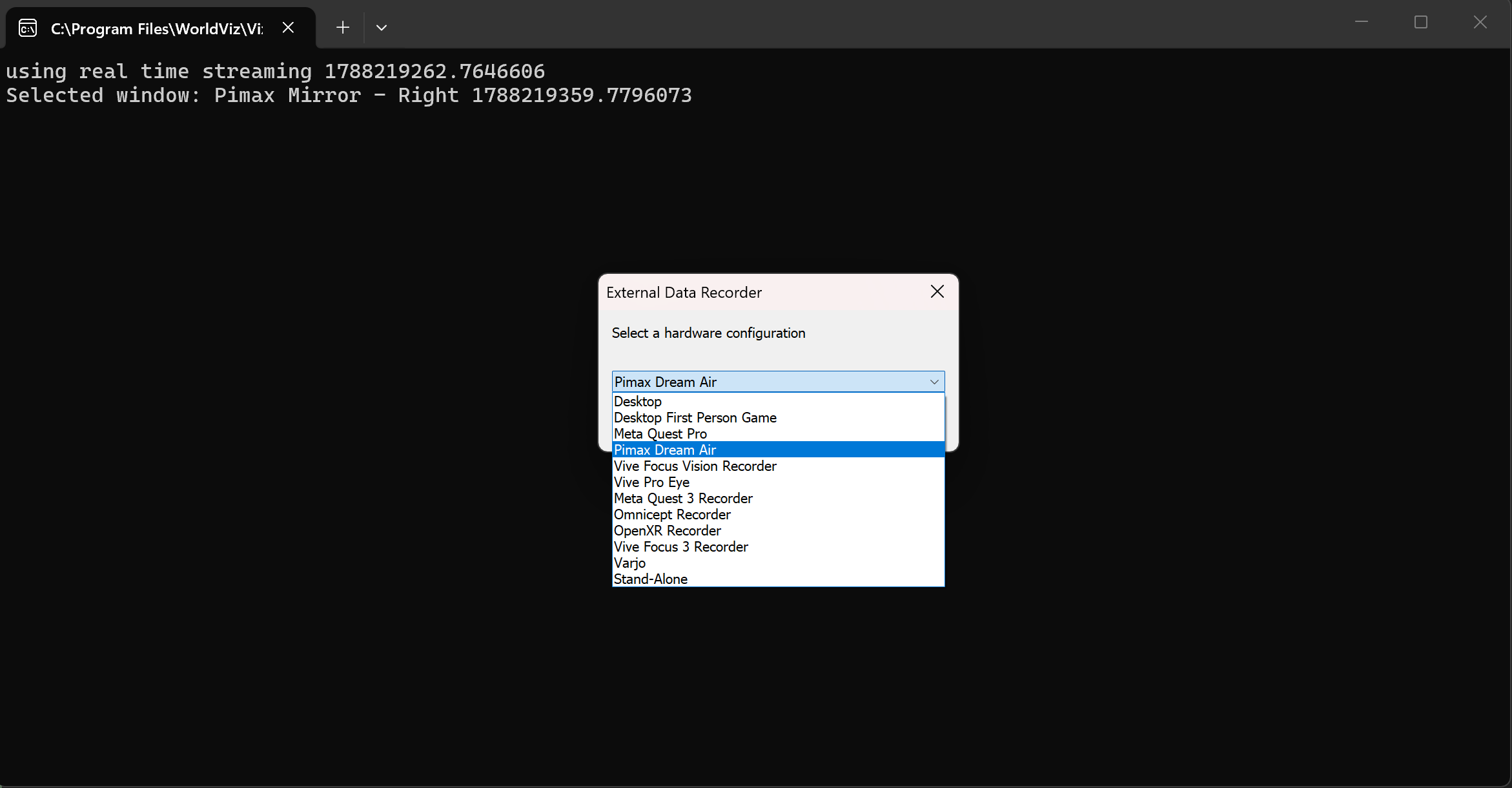

This will bring up a prompt asking you to pick Pimax Dream Air as the hardware config:

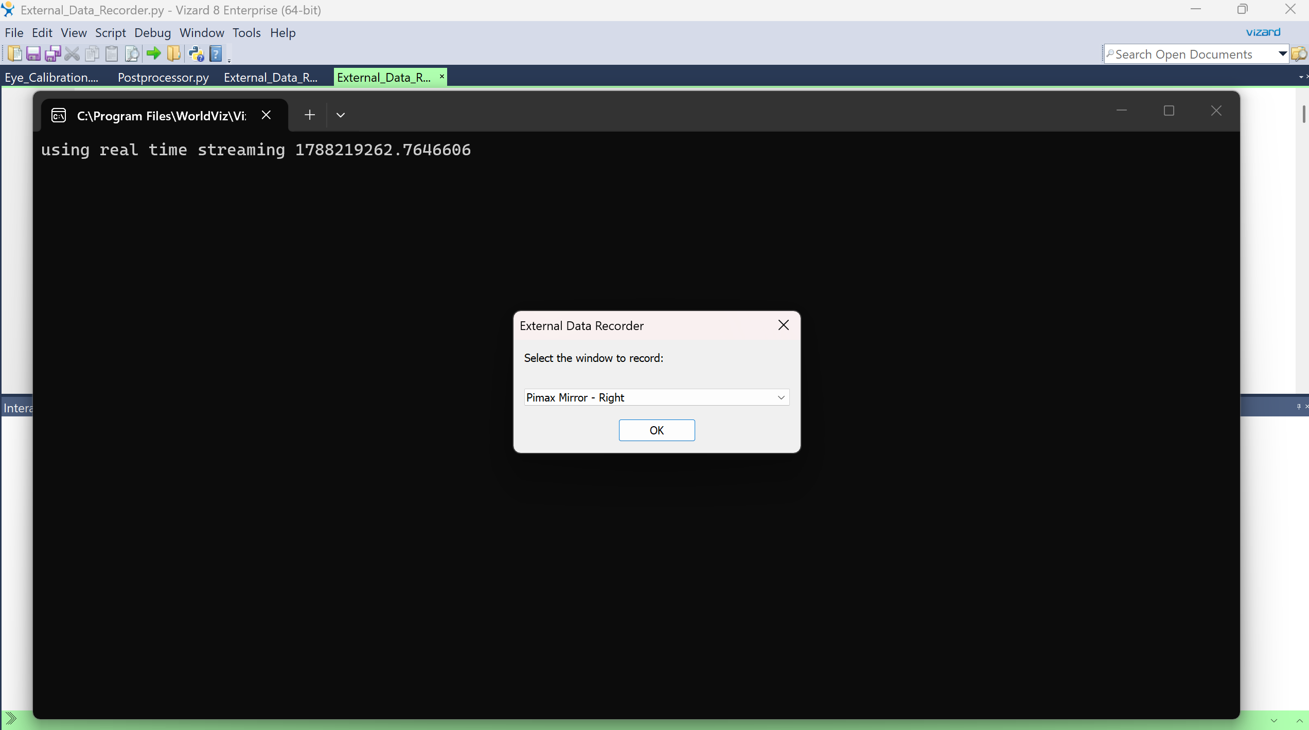

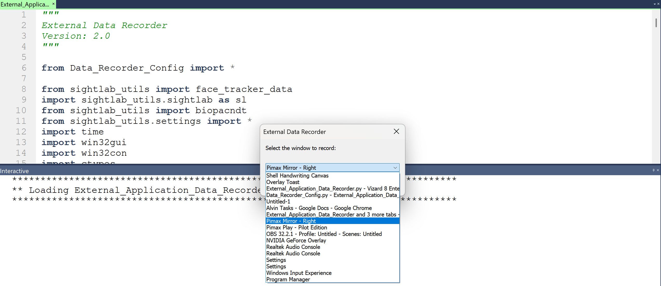

Next, you'll be prompted to choose which window to record:
For the Pimax Dream Air, select the window Pimax Mirror - Right (the screen mirror window we just opened in Pimax EVO) and click OK.

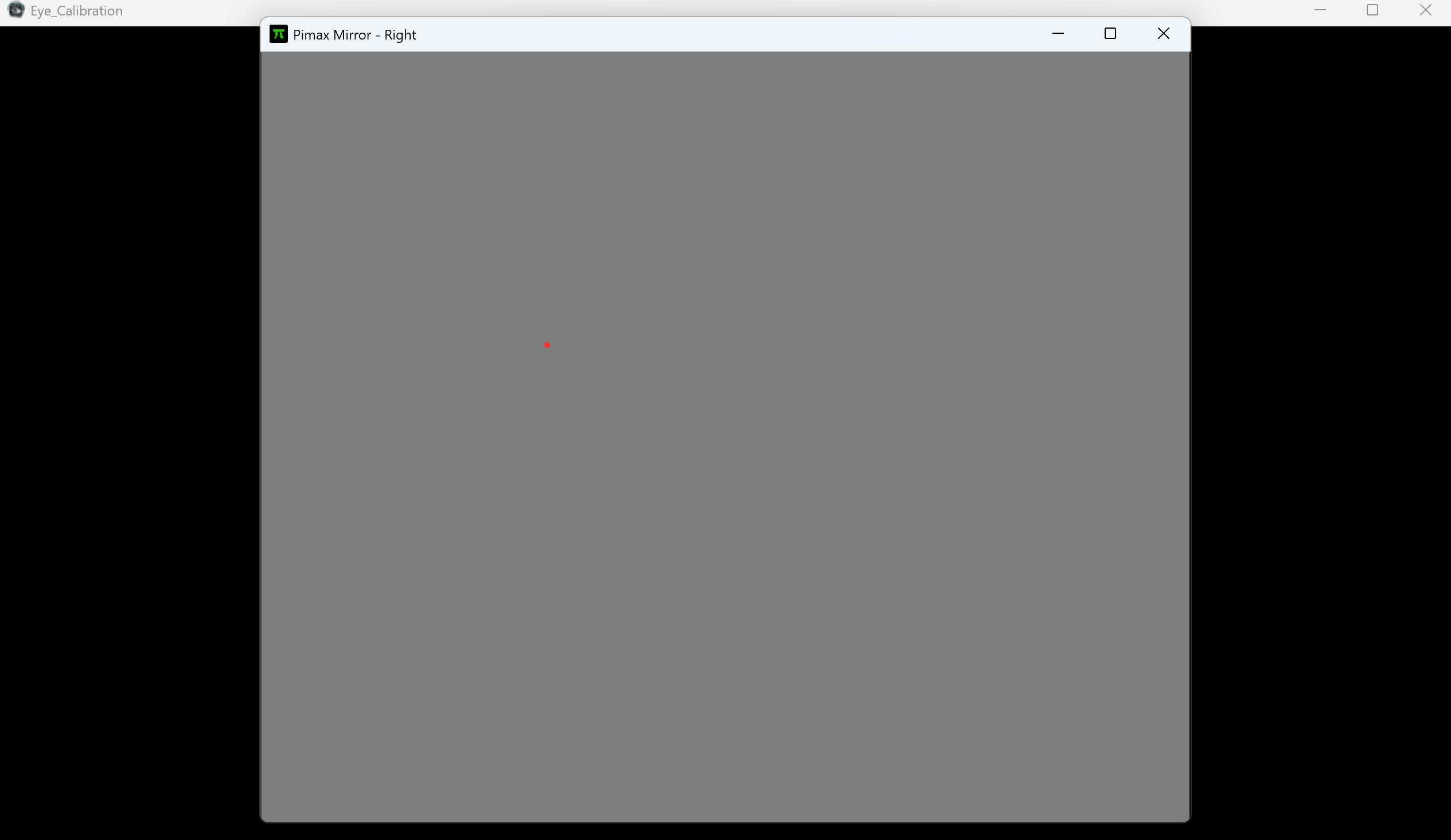

Press trigger on the controller or spacebar on the keyboard to start calibrating. You should see a single red dot like this on Pimax Mirror - Right. The Pimax Mirror - Right window can be occluded, but make sure NOT to minimze it:
The script grabs calibration dot positions from the HMD mirror window (Pimax Mirror - Right) and not the Eye_Calibration window. However, the HMD mirrow window doesn't need to be in the foreground for data to be captured, since the script uses Windows Graphics Capture. This means the window only needs to not be minimized.
Following the instructions from the start screen, fixate each dot before pressing trigger/space and continue fixation until it moves to its next position. Repeat this for each dot.

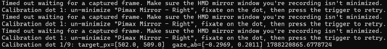

If Pimax Mirror - Right is minimized, you will see the following output in the console when you try to calibrate a dot:
The error will keep showing if you retry and the window is still minimized. The final line indicates that the first calibration dot was successfuly calibrated after un-minimizing the Pimax Mirror - Right window.

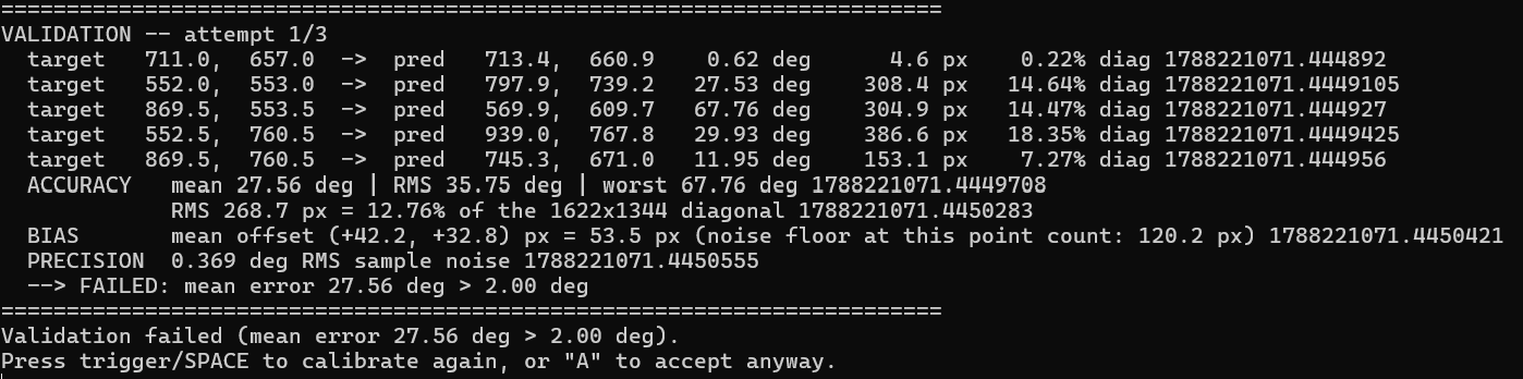

After 9 dots of calibration, an additional 5 validation dots will appear. If the gaze produced for these validation dots exceeds an error threshold, you will see an error message in the console window:
You may press the "A" key to accept a faulty calibration, or trigger/space to restart calibration. Note that the gaze mappings are likely to be inaccurate if you accept a faulty calibration. If all three rounds fail validation, the best in terms of mean angular error (degrees) will be kept.

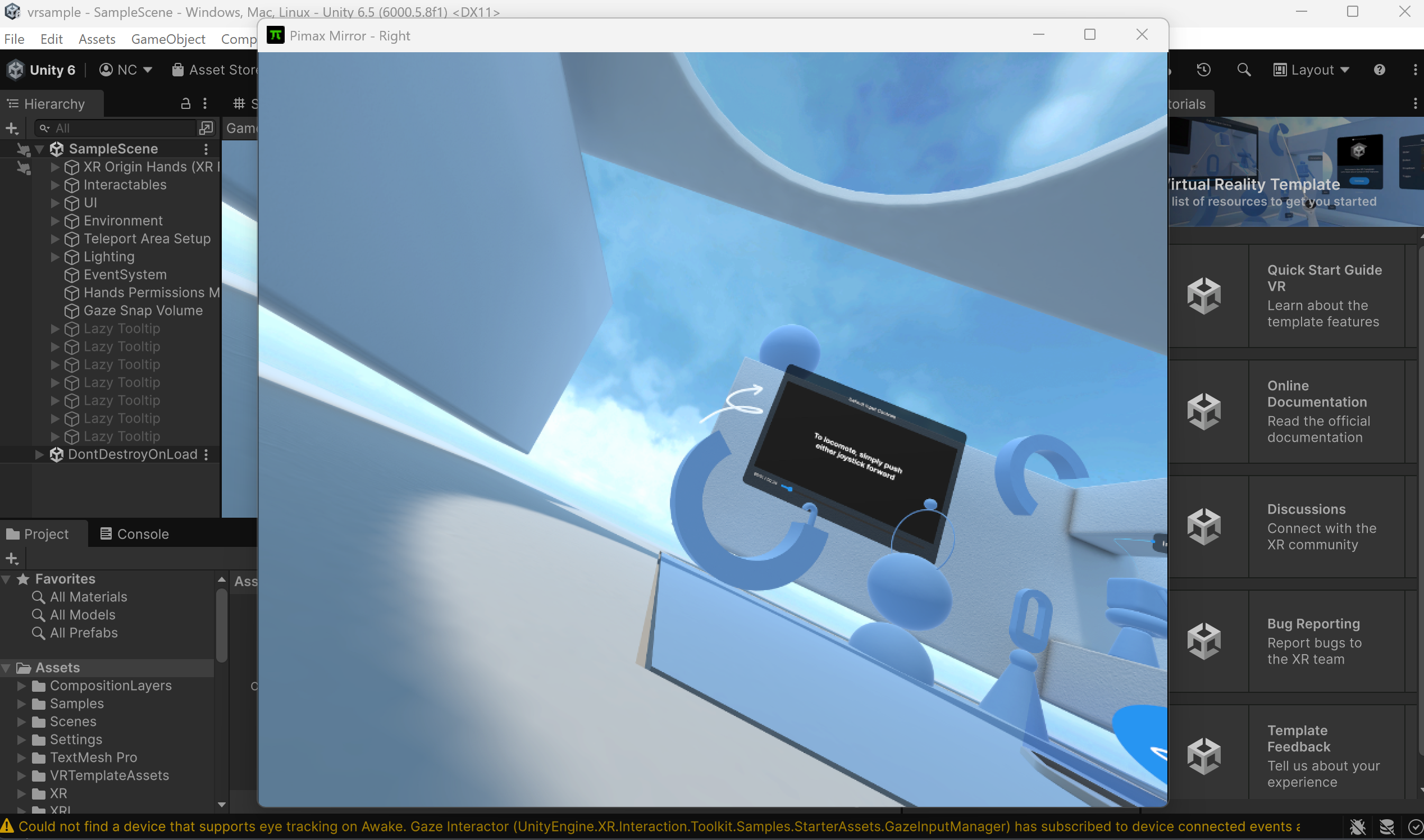

This tutorial will demo a Unity VR application. Before clicking "OK", open your external application.
After opening the external application, lets ensure it shows up on the HMD mirror:
Looks good!

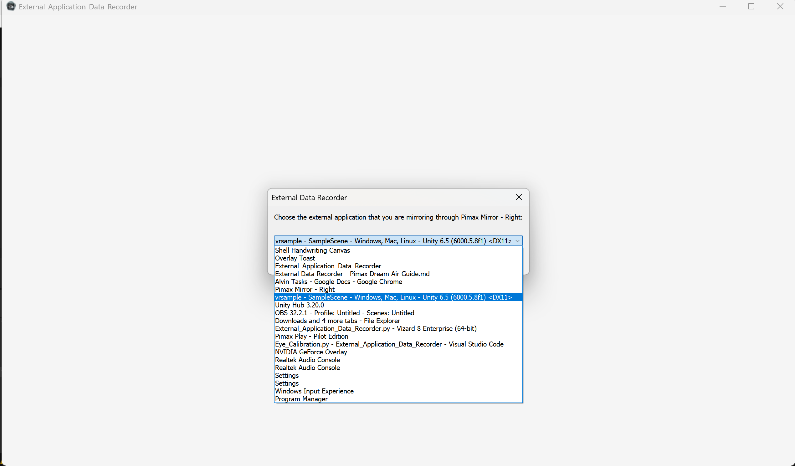

Next, you'll be prompted for the actual external application you're recording through the HMD mirror (in our case, Pimax Mirror - Right). Choose your external application and click OK. For this tutorial, we choose the Unity project:
This will automatically switch desktop focus to your external application so it shows up in the Pimax Mirror - Right window and your HMD, since the External Data Recorder briefly takes its place before the session starts.

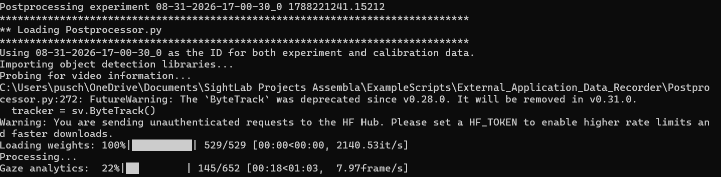

If you switch back to the External_Data_Recorder window, you should see a message saying the script is being postprocessed, which entails transcoding and overlaying the video with RT-DETR object detection and gaze information:
After this, you can start the session recording by pressing the spacebar. You should see a red dot appear next to the OBS icon in the task bar once you press spacebar, indicating that OBS is recording.
At the end of your session, a beep will play to signify that the trial has ended.
The OBS dot will disappear to indicate it has finished recording.
The console window provides postprocessing progress updates:

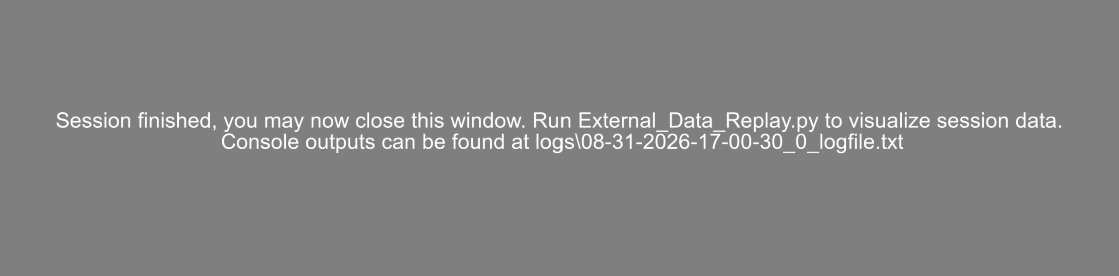

Once postprocessing is finished, the External_Data_Recorder window will let you know:
It is now safe to close the External_Data_Recorder window. This will save the console window outputs to a log file, listed in the message.

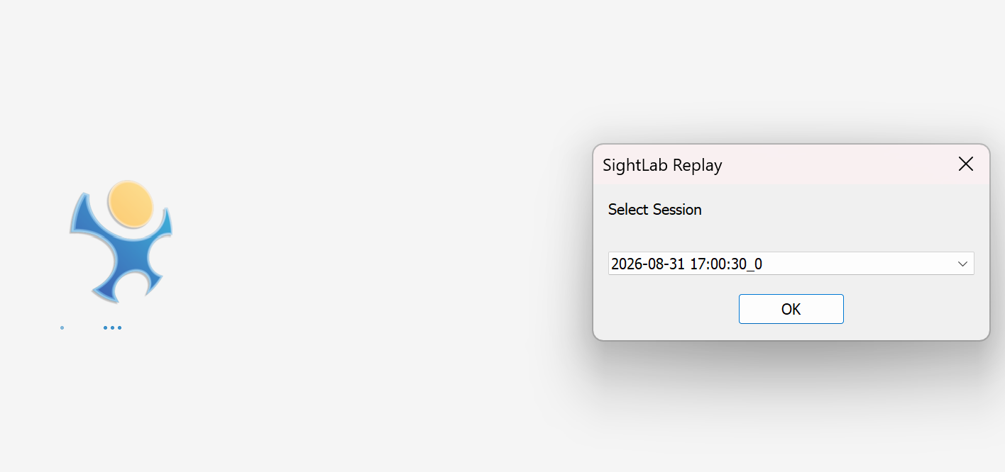

Replay
To operate the replay, you can open it from the Vizard IDE, directly, or the External Data Recorder tab in the SightLab Dashboard:
This will open a window named External_Data_Replay and prompt you to select a session. Sessions are named by the datetime they were recorded, and the participant id:

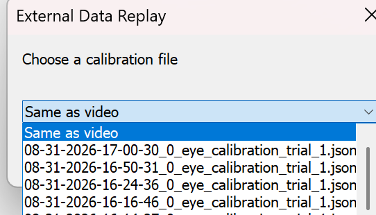

Next, it will ask you to select a calibration file to use with the selected session:
If you ran a calibration in the same session you ran the recording (the flow described in this guide), select Same as video. If you reused an old calibration from another session, you can search for it in the dropdown.

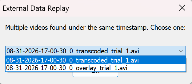

Next, select a video to use in the replay. You can choose from either the overlay video, which has the RT-DETR object detections overlaid on the video, or the transcoded video, which has no postprocessing overlays.
See Session Replay and the full Session Replay documentation for more instructions on how to use the replay. Make sure to full-screen the External_Data_Replay window.
