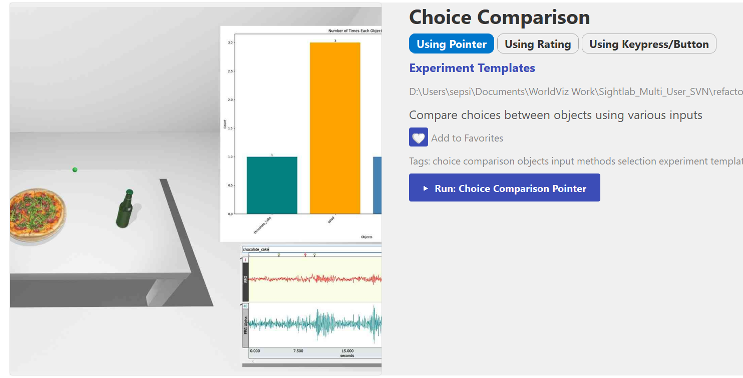

The Choice Comparison Template is a versatile SightLab experiment template designed to allow participants to make choices between two objects using various input methods: laser pointer, rating scale, or keypress. This template can be easily set up using either the SightLab GUI or leveraging the built in SightLab and Vizard code, as well as expanding with python. The default configuration involves choosing between two food items, but it can be adapted for various comparison tasks.
Use for Consumer Preference Studies , Product Placement, Decision Making Strategies and more.
On the SightLab Dashboard you can choose from "Using Pointer", "Using Rating" or "Using keypress/button"

  • Graph Generation: Automatically generates bar charts summarizing the number of times each object was chosen across trials.

Data Analysis and Visualization
The template provides tools to analyze and visualize the data collected during the experiment. This includes:
  • Choice and Time Data: Stores the chosen object and the time taken to make the choice.
  • Graph Generation: Automatically generates bar charts showing the number of times each object was chosen across all trials.
